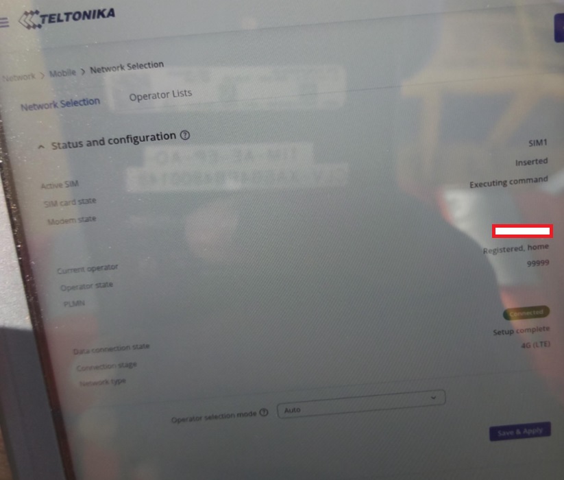

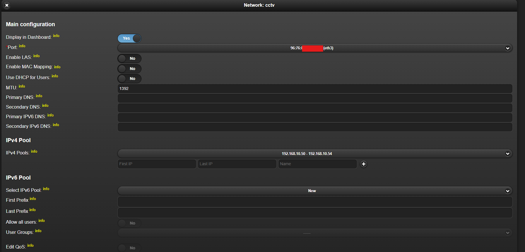

I have a RUT241, we are connected to our 4G private network operator (99999), however, the router is connecting to the default APN of the ePC (172.17…….) despite the fact that i attributed a specific group and IP address (192.168.10.xxx) onto the ePC side. The IP (192.168.10.xxx) address is obviously pointing to the APN I want to connect to.

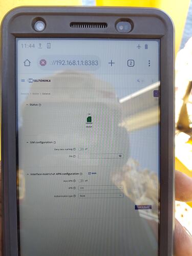

The APN has also been mentionned into Network –> Mobile –> General.

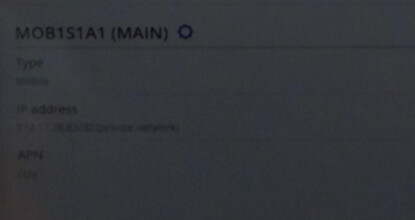

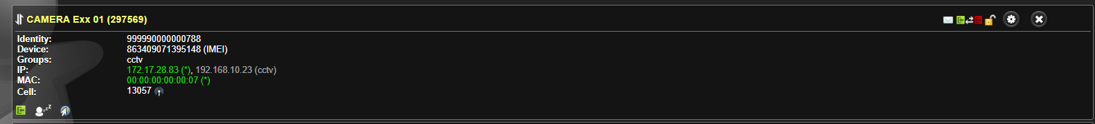

IP address obtained:
172.17.28.83/32

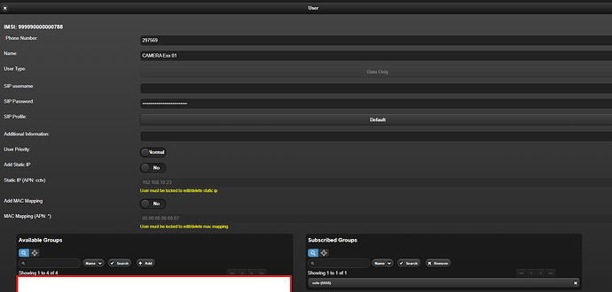

IP address fixed onto ePC: 192.168.10.23 and APN cctv:

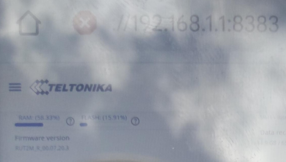

Could you please share the firmware version of the device that you are using?

We are using the last published on website, Teltonika version: RUT2M_R_00.007.20.3
Regarding the APN, you are right, we are using a customed APN, but there is no login/password on this one:
Configuration of the user (RUT241) :
Thanks in advance,
