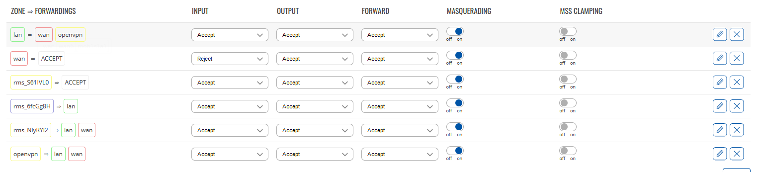

FW zone forwding done but still cannot see the device from OpenVPN

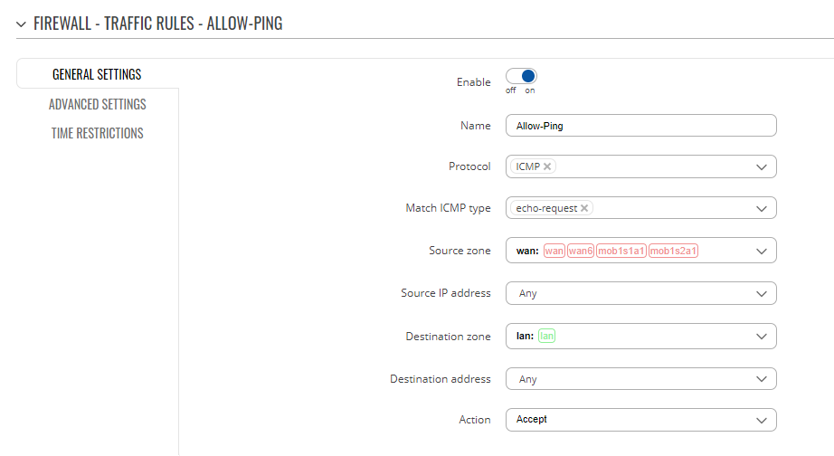

Can you try to go to Network → Firewall → Traffic Rules → click pencil icon for Allow Ping.
Then, there should be source zone: openvpn and destination zone: lan.
Let me know if this cleared your doubts.

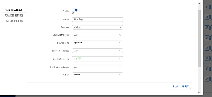

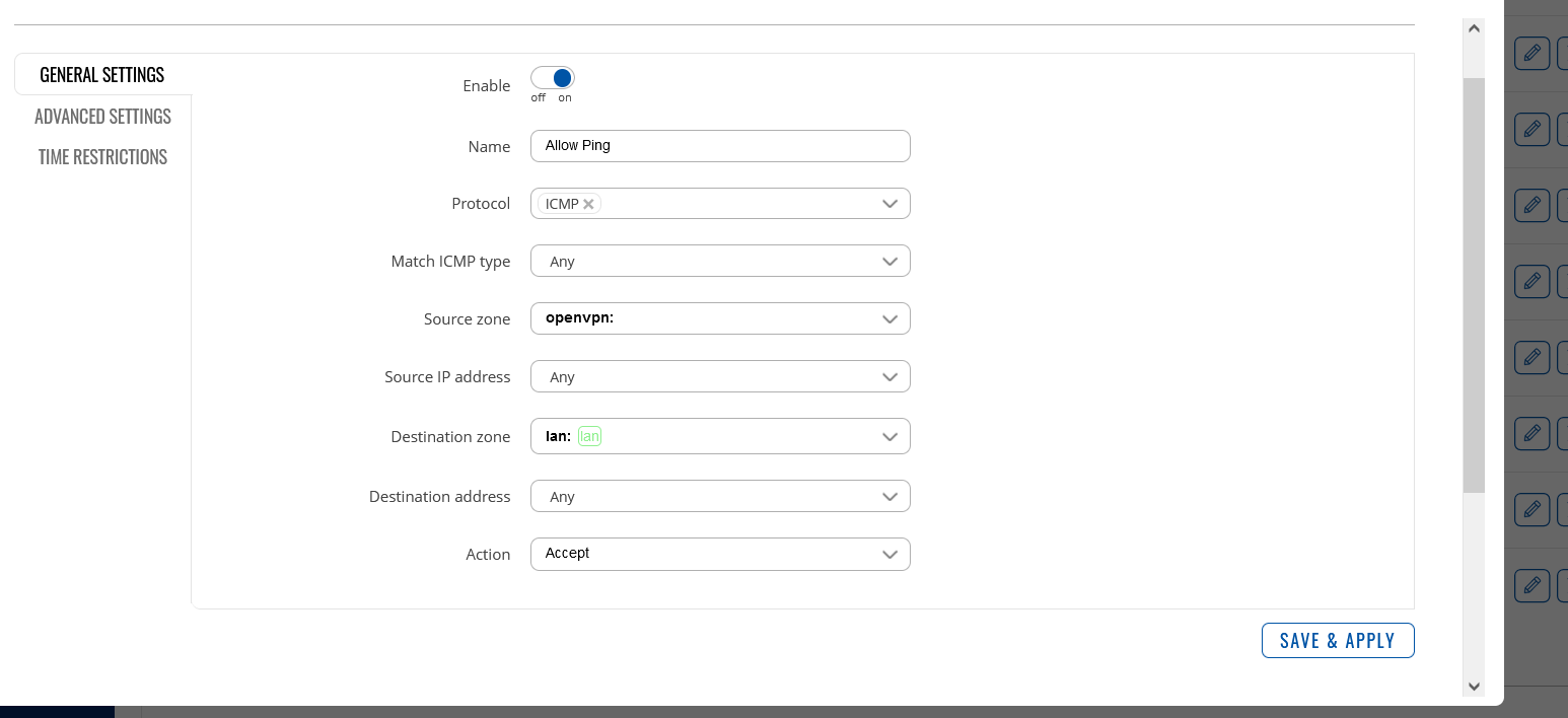

Dear Support,
I tried creating the FW traffic rule as below but still no luck. Cannot ping the LAN IP from from my OPENVPN Server
