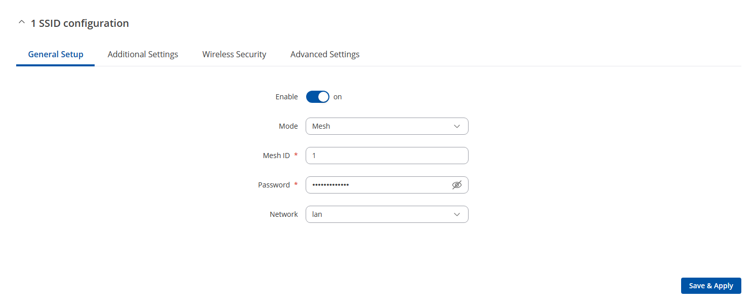

  • General Set up of Mesh ID 1

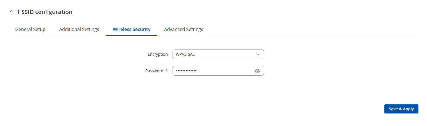

  • Wireless Security (WPA3-SAE was used for all Mesh)

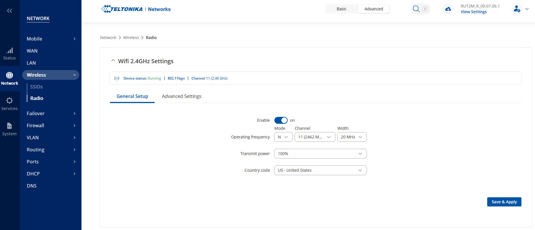

  • Wi-Fi Radio Channel (should be identical. Channel 11 was used in the document)

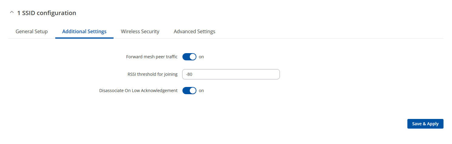

the mesh network configuration is like with example. I verified again it.
That are the screenshots requested.

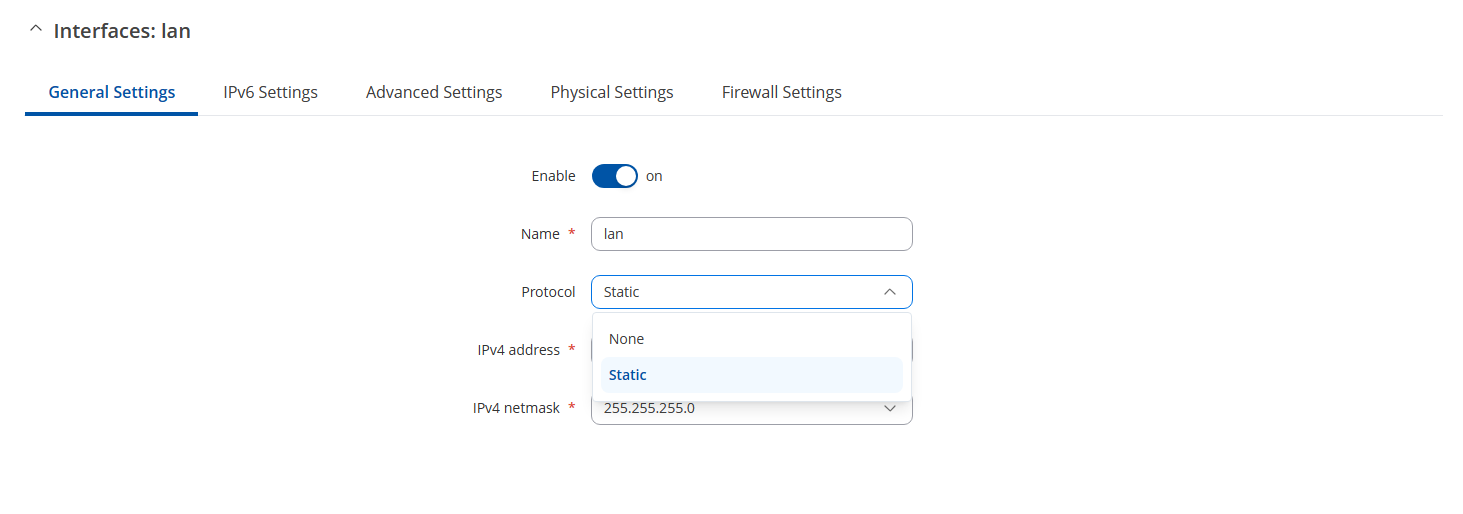

Do you know because in my routers is not possible choose DHCP protocol in LAN General Settings?
