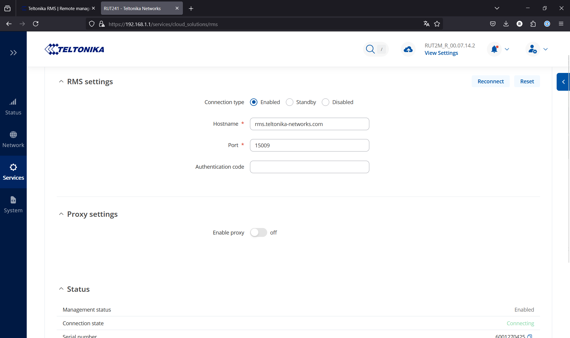

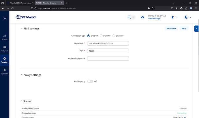

I have 3 RUT241 routers one of which is brand new and two of which are maybe 1 or 2 years old. The brand new one I am able to connect to the RMS service but both of the 2 old ones both show the same error.
They keep on showing ‘Connecting…’
Sometimes a short moment ‘Down’ will be shown in the status but after that it tries to reconnect and goes back to ‘Connecting…’
I have put both of the routers back to factory setting multiple times and also removed them as a device from the RMS portal and added them again but nothing changes.
All 3 of my RUT241 routers are running the most recent “RUT2M_R_00.07.14.2” firmware
I also made a backup of the working router and uploaded them to the 2 non working routers but nothing changes.
I checked de system logs and I found the error below:
471 Sat May 10 17:27:14 2025 daemon.err rms_mqtt[9716]: [handle_mosquitto:184] error: Reached max initial connection attempts (5), exiting
472 Sat May 10 17:27:14 2025 daemon.err rms_mqtt[9716]: [handle_mosquitto:188] error: Error connecting with mosquitto: Network unreachable
473 Sat May 10 17:27:14 2025 daemon.err rms_mqtt[9716]: [main:151] error: Failed to initiate mosquitto loop
What does this mean?
All other functionallity works as expected except the RMS service. Both routers also have a functioning 4G connection to the internet.
What can be the problem?
