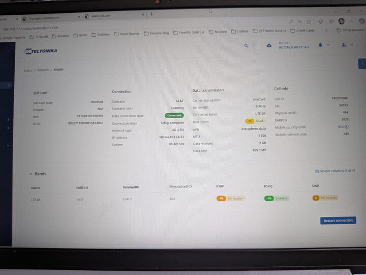

We switch off Auto APN to this apn: ksx.sphere.data and the internet connection always just stay for 5 mins and it’s gone and need to reboot again. We test for many times. It’s still the same. It’s KDDI Sim card.
Try this, might be an IMS issue
