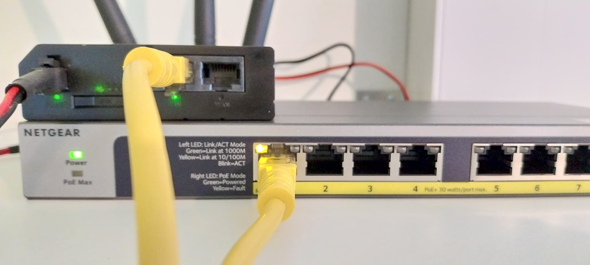

I actually already have the appropriate cable:
This one was provided with a low cost Chinese router and should be good enough to suit my need.

I confirm that my RUT241 works as expected when connected to my Netgear GS108LP POE switch with an Ethernet cable that only has two pairs wired on pins 1, 2, 3 and 6.
