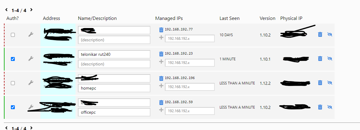

I checked and my rut240 and the pc which I am accessing the rdp from is online as seen below

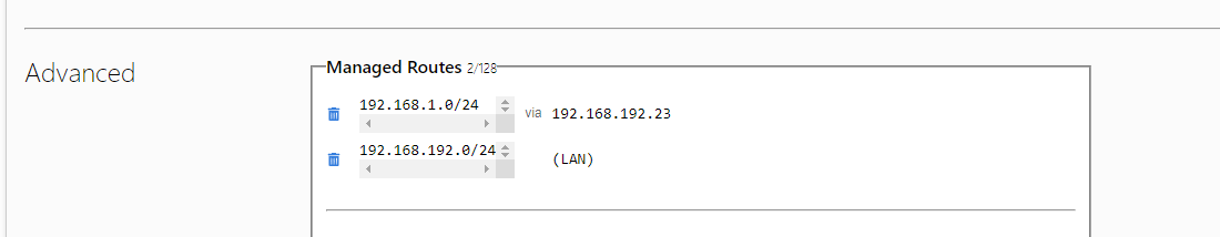

In the managed route section I have created the managed route as per below

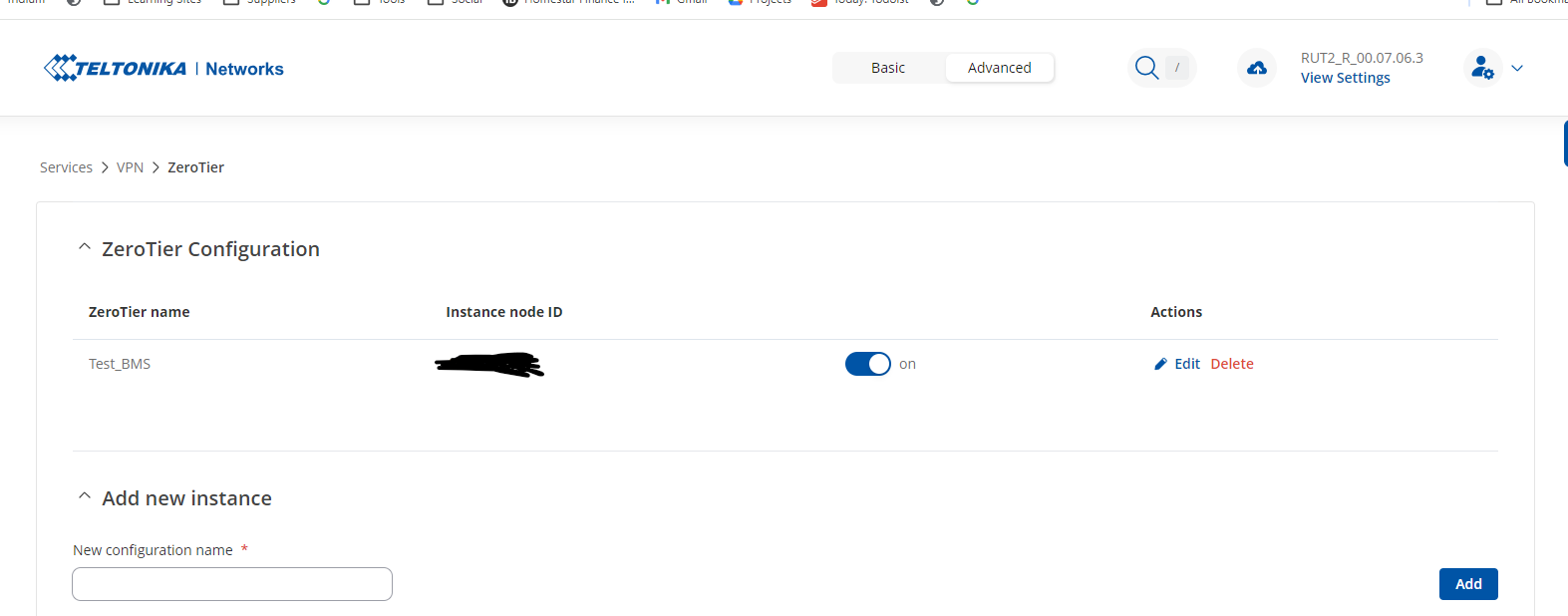

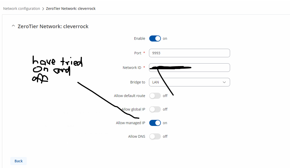

I have installed zerotier package and put in my network info in the RUT240 as per below

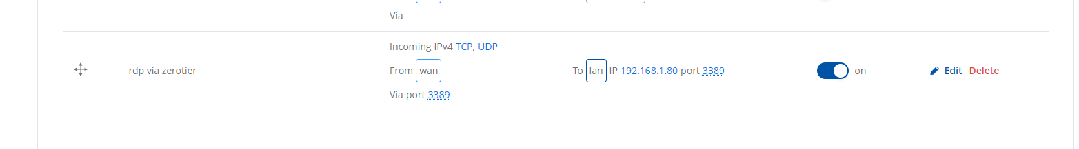

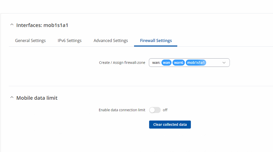

In the port forwarding of my rut240, I have port forwarded port 3389 as per below
However when I tried to drp to 192.168.1.80, I can’t. I tried pinging the rut240 zerotier ip which is 192.168.192.23 from my pc which has zerotier ip of 192.168.192.59 but no success. Can anyone tell me what I have done wrong? Thanks in advance

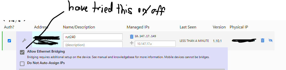

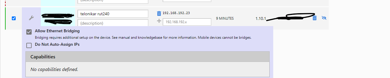

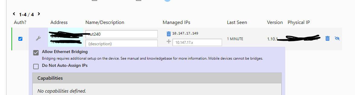

more info… i have also allowed bridging on the zerotier config as per below

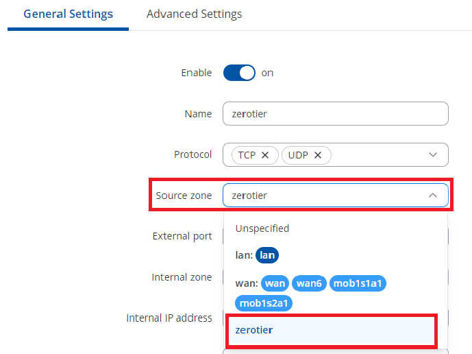

Upon reviewing the screenshots you provided, I observed a mistake in the port forwarding rule. Specifically, the source zone is currently set to wan, but it should be configured for zerotier.
Please let me know if it helped to solve the issue
Marija
Hi Marija!!

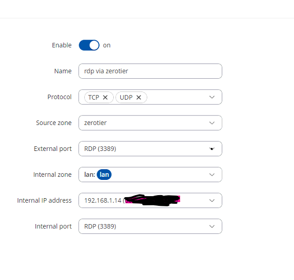

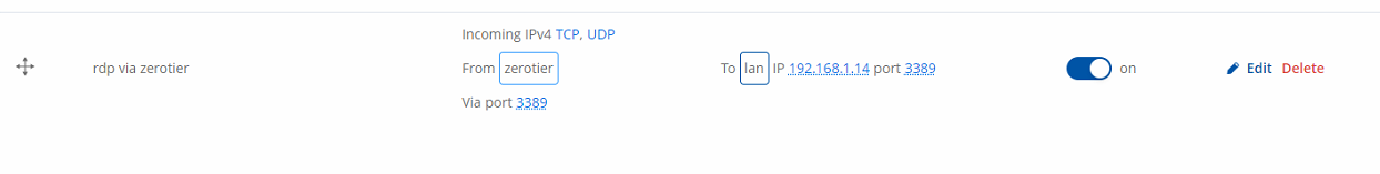

Extremely grateful for your time to look at my issue. I tried changing the source to zerotier but still same outcome as per below. Decided to try RDP to PC (192.168.1.14 instead).

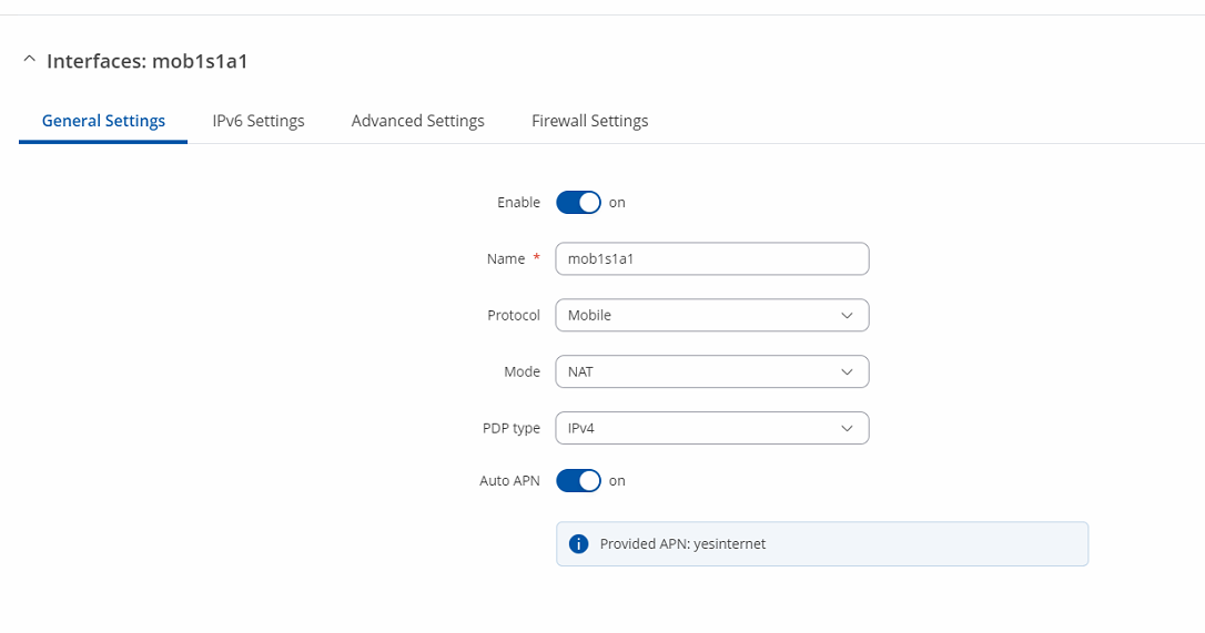

Could it be my sim card being CGNAT and not static ip?

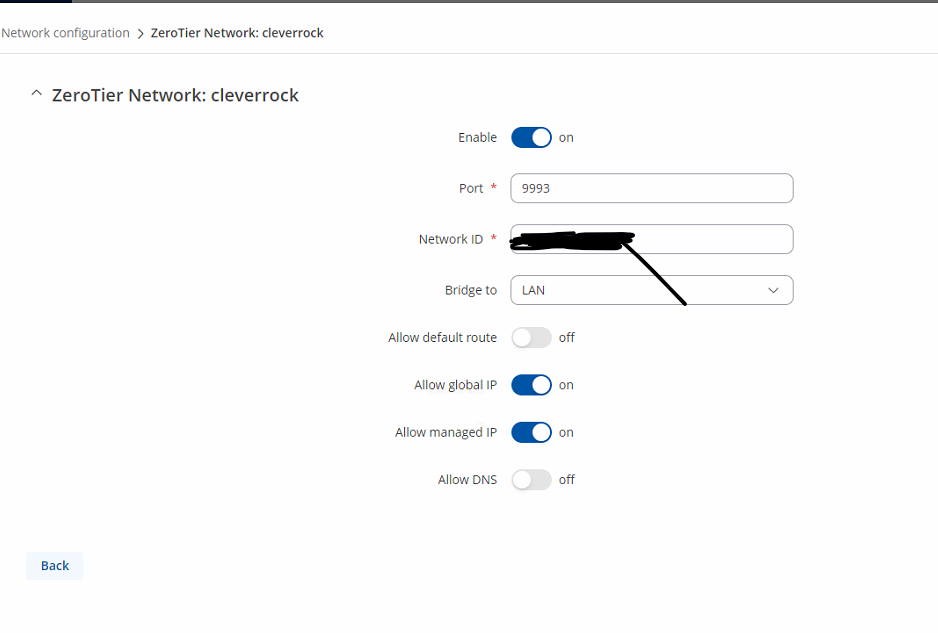

Bridiging still enabled in zerotier as per below

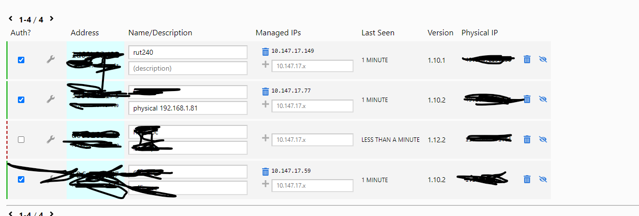

Another thing to note… i can ping other devices on the zerotier network except for the telnonika rut240
(ip 10.147.17.149)

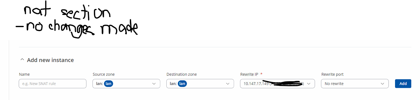

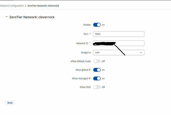

Zerotier setup
You need to set “Allow global IP” in the ZT config of the RUT.
Hi!
Juat tried and still cannot ping the RUT with zerotier ip of 10.147.17.149 from my external pc

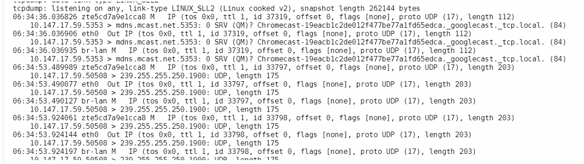

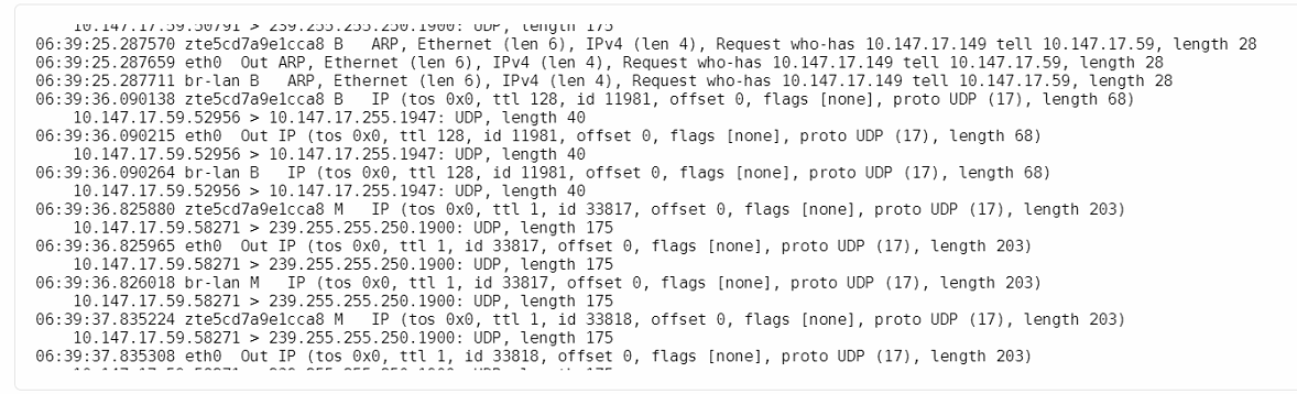

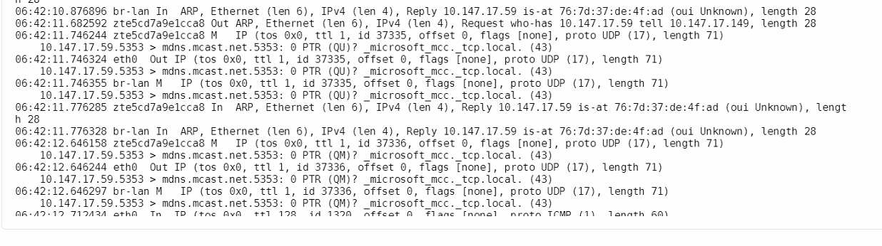

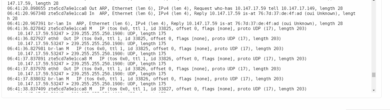

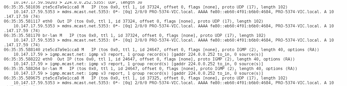

Do a tcpdump on the rut:
tcpdump -i any -n -v 'host 10.147.17.59'
and a ping 10.147.17.59 from A or B.
What is the output of tcpdump ?
Hi!! thanks for looking at it… i did a tcp dump but don’t know how to interprete
Pinging 10.147.15.59 from A. Result of tcp dump
I can’t find any ICMP echo request frames nor echo reply ones either in the tcpdump output.

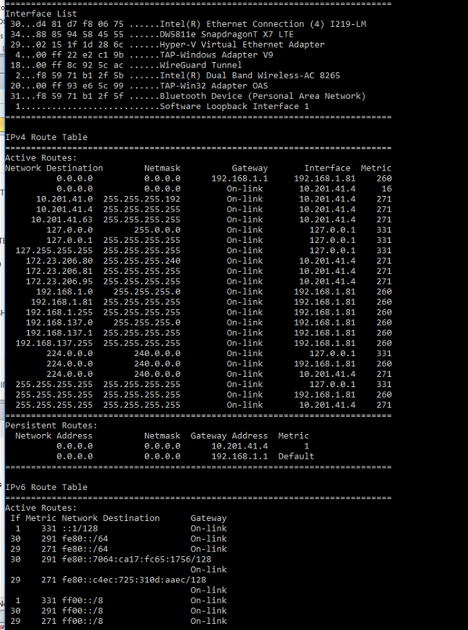

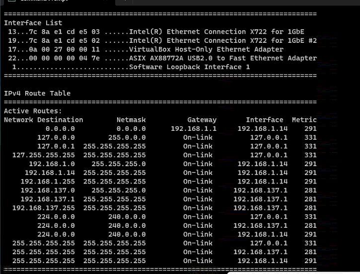

What is the default route on A ? On B ?
Thanks for the time … Can I please know what you mean by default route? Do you mean the managed route? If so its via the RUT.

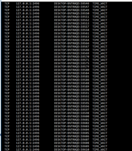

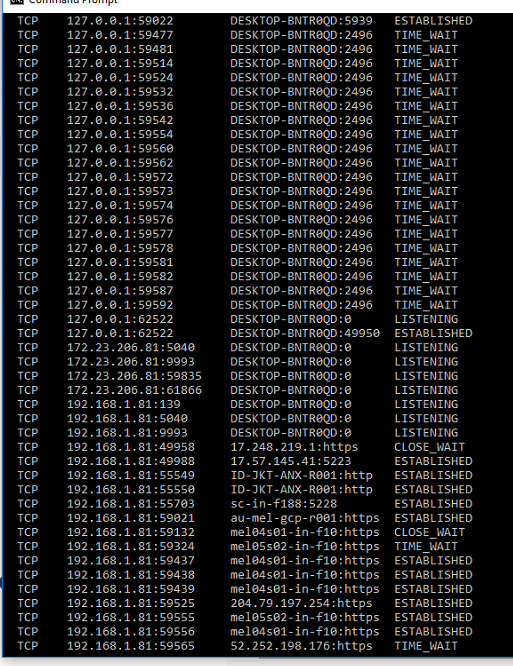

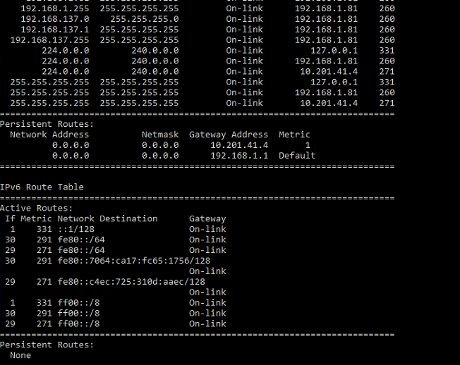

The result of “netstat -rn” on A / B.

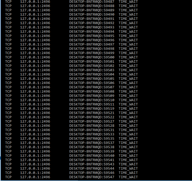

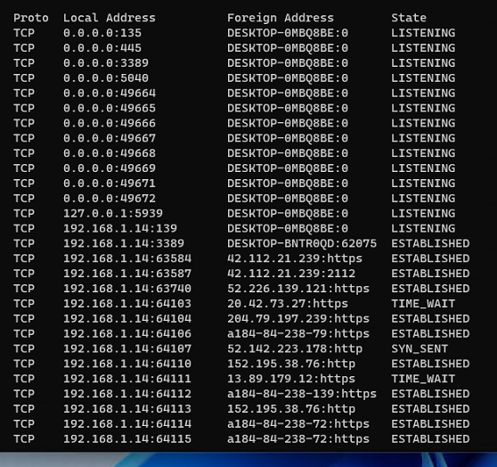

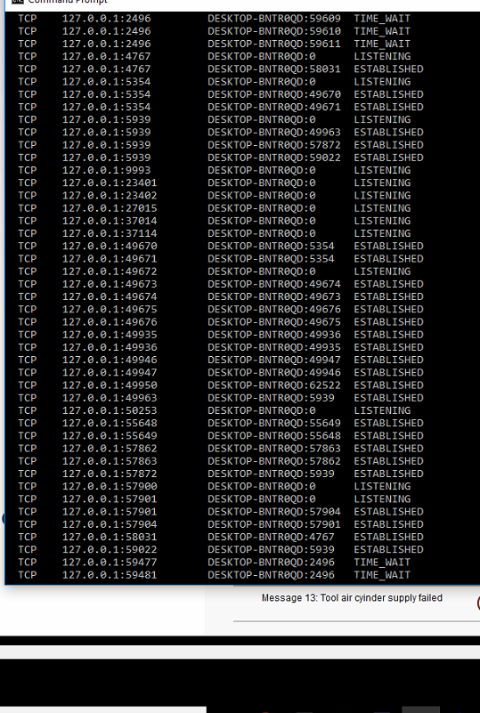

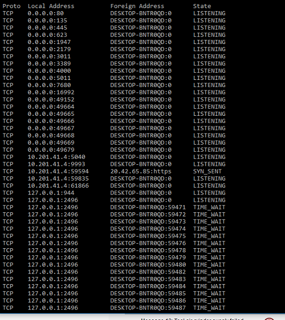

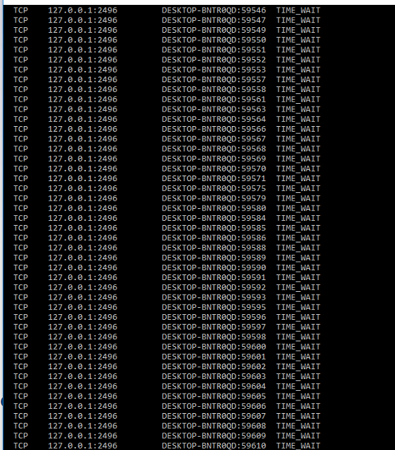

Hi

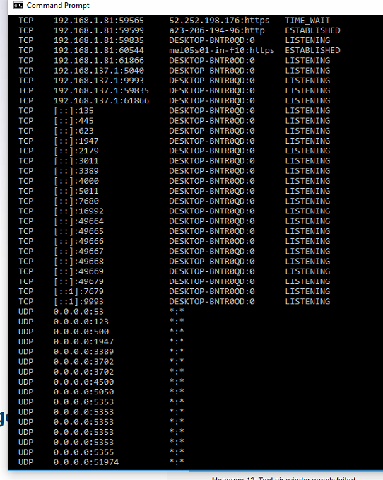

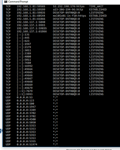

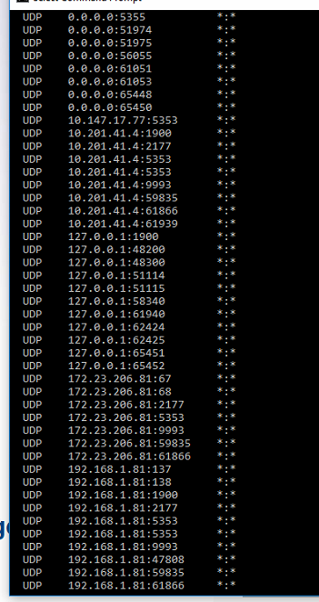

Netstat - a From A
netstat -a from b
Hmm no. netstat -rn not netstat -a.

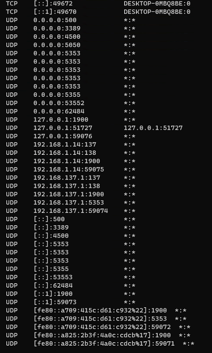

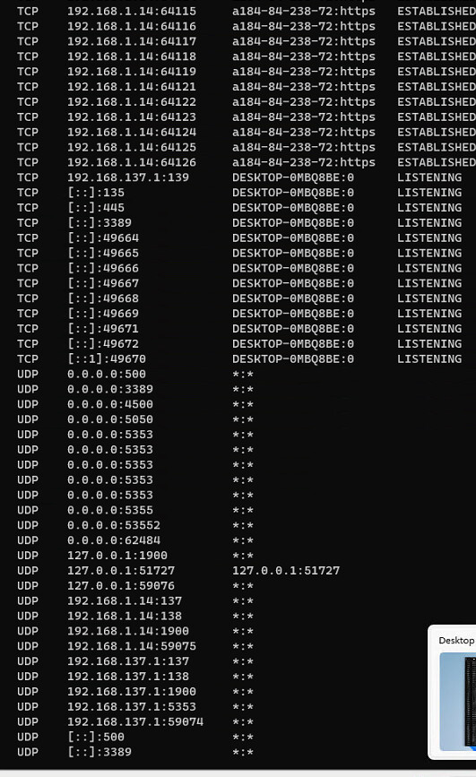

Hi
One more try
netstart - rn from a
netstart - rn from b
Looks correct. From A or B can you ping 10147.17.149 ?
