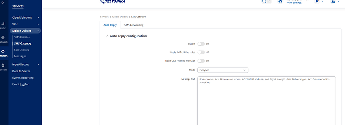

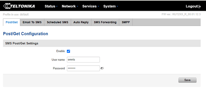

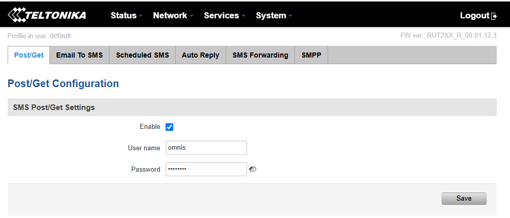

We are using the RUT240 as our SMS module to ouer system Omnis. so my question is:
Where can i find the menu SMS Gateway and Post/Get Configuration in the RUT241 ?
I can find the SMS Gateway but not the SMS Post/Get Settings

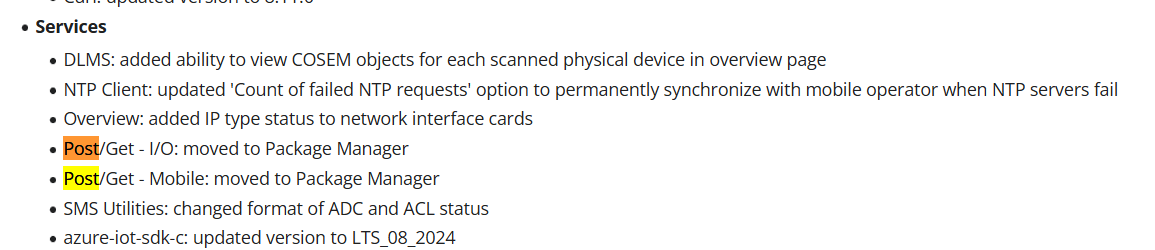

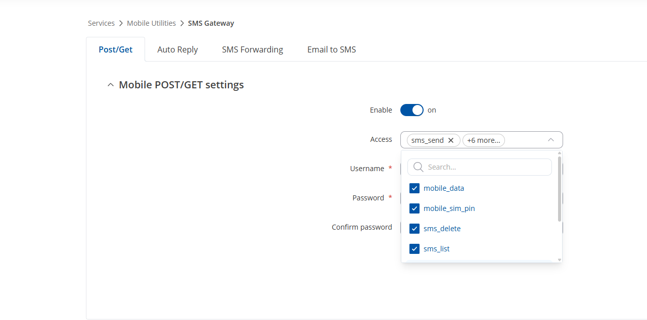

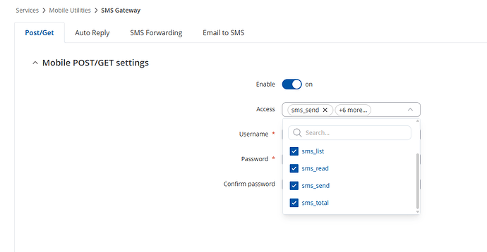

This functionality was moved to the Package manager as can be found in the firmware changelog:
Under here: https://wiki.teltonika-networks.com/view/RUT241_Firmware_Downloads
Simply head to System → Package manager → Search for “post” and install it.
MatasR
March 18, 2025, 8:41am
5

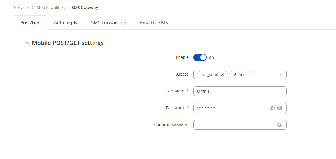

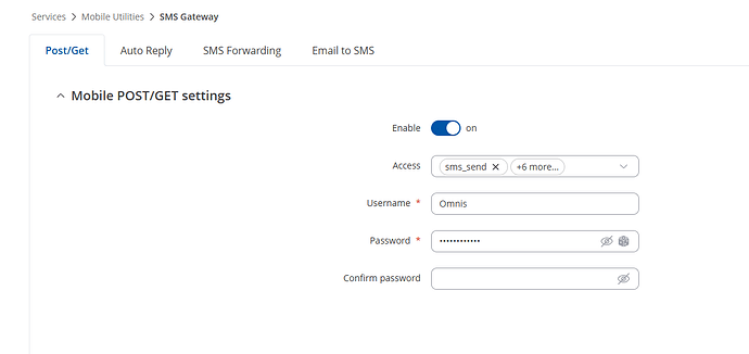

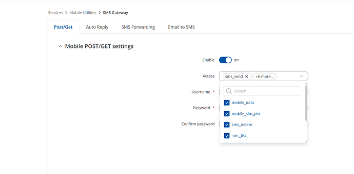

Looks correct, however, if it does not work, make sure to also enter your password in the Confirm password field.
HI again.
Works 100%, thanks a million
