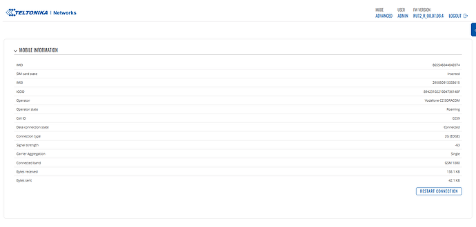

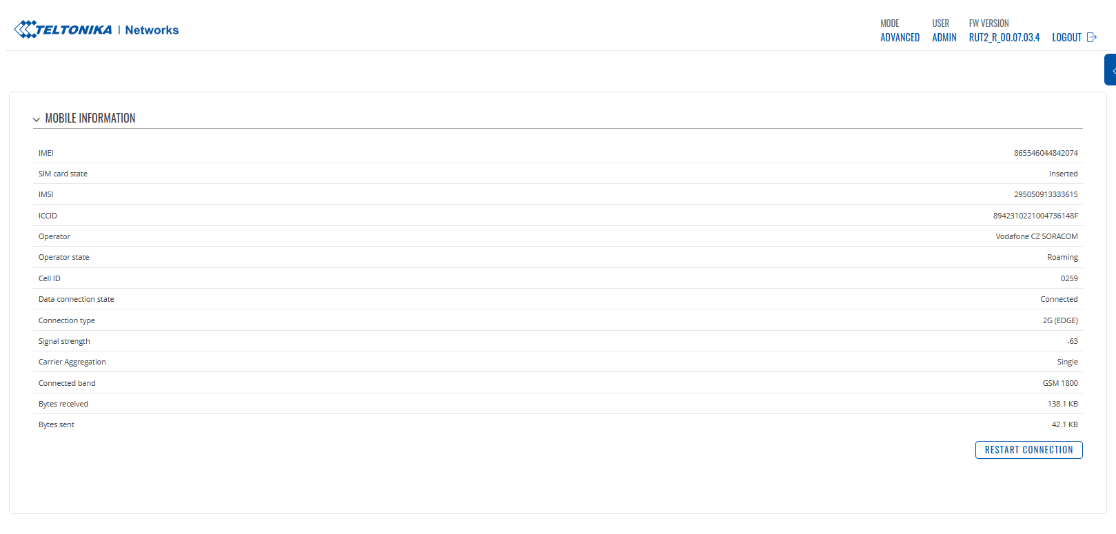

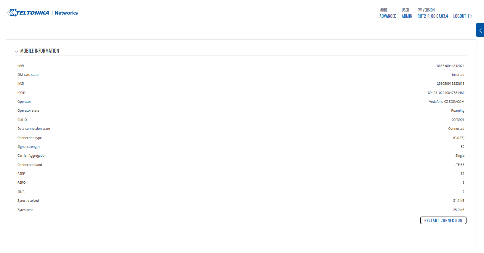

@anon75013366 thanks for the quick response:
1 - All the configs are done on RUT240 but the setup will be also used on older RUT230s so I must use only the latest firmware available for RUT230. The devices will communicate with the same settings. So the debugging right now is done on RUT240.
2 - There was another SIM before so the devices was connected and working. I tried it with Soracom IoT SIM and it works all good (see the picture below 2G and 4G works with Soracom).
