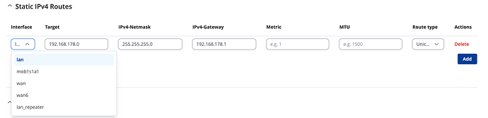

I added a static route
Target, Networkmask and Gateway IP are correct but I am still not able to ping devices in the other network

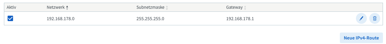

I am using the same in my FritzBox
and there its working
Any idea ?

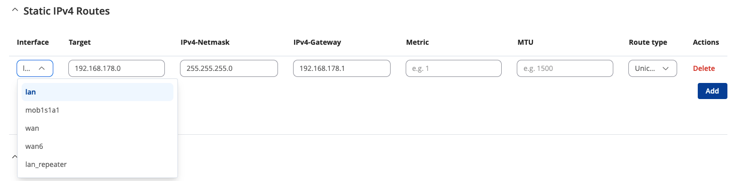

@Nisbo Hello,
From your screenshot, you have set 192.168.178.0/24 as the target network and 192.168.178.1 as the gateway.
If 192.168.178.0/24 is directly connected to the RUT device, there is no need to add a static route. The network is already associated with that interface. However, if it is not directly connected, then the gateway you specify in the route must be one that the device can actually reach. Right now, you are telling the device to use 192.168.178.1 as the gateway to reach 192.168.178.0/24, but that means the device already needs to know how to reach that network, making the route incorrect. You need to specify the gateway IP to be on the same network as the interface from which it should be reachable.

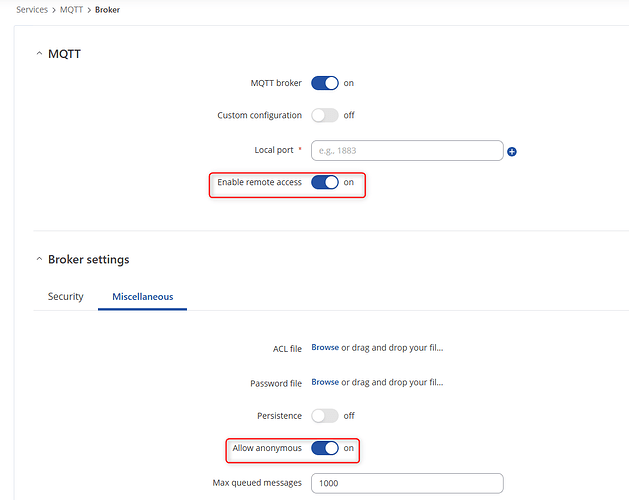

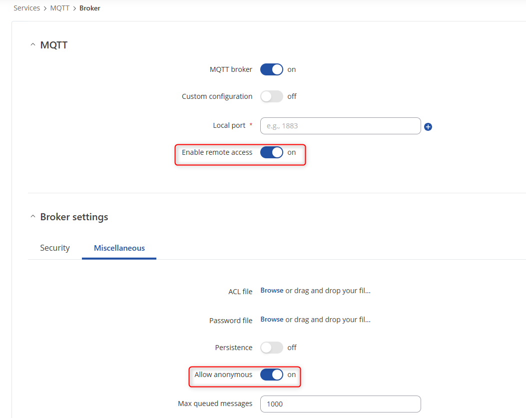

As for the MQTT - if you connected the UDM to a WAN port and are trying to access MQTT on the RUT from the WAN side, ensure that remote access is enabled for MQTT traffic. Also, check if β€˜anonymous’ access is allowed.
Additionally, go to System β†’ Administration β†’ Access Control β†’ Security tab and check if MQTT access from your IP was blocked. If MQTT authentication fails multiple times, it will increase the failed attempts counter, and once it reaches the configured limit (10 by default), MQTT traffic from that IP will be dropped.

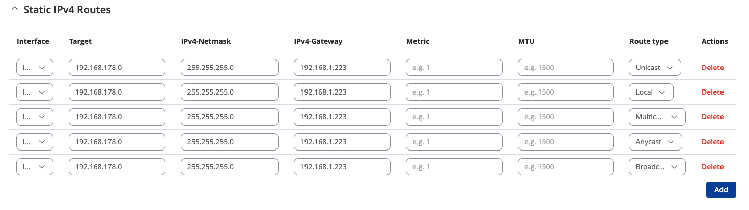

So I configured the static routes again for the 5 route types, but still not working.
Which route type do I need for ? All 5 ?
UDM routing table as shown in the last post.

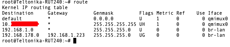

RUT routing table:
root@Teltonika-RUT240:~# route
Kernel IP routing table
Destination     Gateway         Genmask         Flags Metric Ref    Use Iface
default         *               0.0.0.0         U     1      0        0 qmimux0
10.x.x.x        *               255.255.255.255 UH    1      0        0 qmimux0
192.168.1.0     *               255.255.255.0   U     0      0        0 br-lan
192.168.178.0   192.168.1.223   255.255.255.0   UG    0      0        0 br-lan

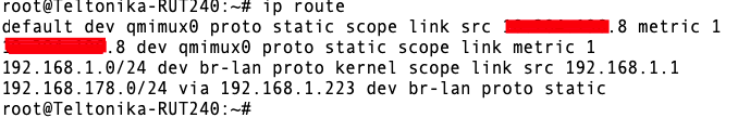

root@Teltonika-RUT240:~# ip route
default dev qmimux0 proto static scope link src x.x.x.x metric 1
x.x.x.x dev qmimux0 proto static scope link metric 1
192.168.1.0/24 dev br-lan proto kernel scope link src 192.168.1.1
192.168.178.0/24 via 192.168.1.223 dev br-lan proto static
ping not possible to
  • 192.168.1.223 (UDM WAN IP)
  • 192.168.178.1 (UDM)
  • 192.168.178.27 (Broker)

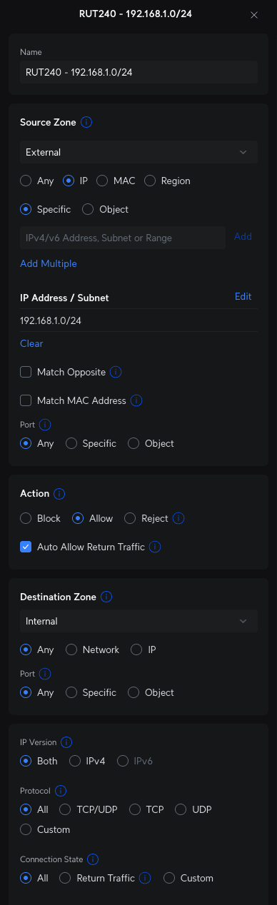

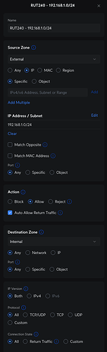

Looks like it was the firewall setting.
For the search function / Google:

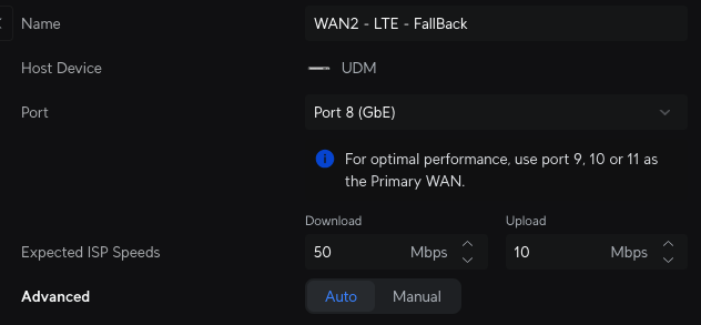

On the UDM, I added a rule for External β†’ Internal for the 192.168.1.0/24 net
Network settings for the WAN from the RUT are now on AUTO

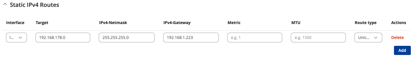

On the RUT, I created the Static route
Interface: Lan
Target: 192.168.178.0
Netmask: 255.255.255.0
Gateway: 192.168.1.223
Type: Unicast
