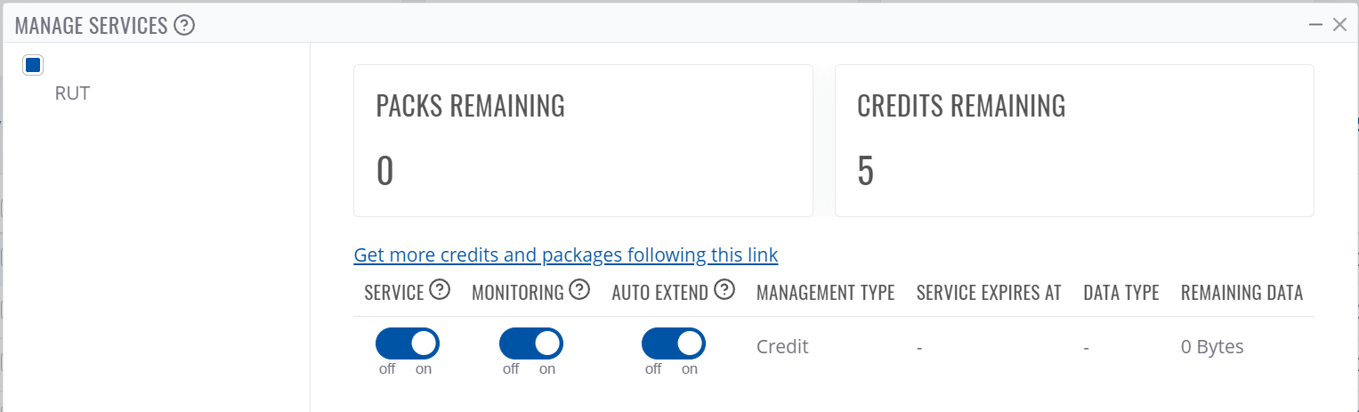

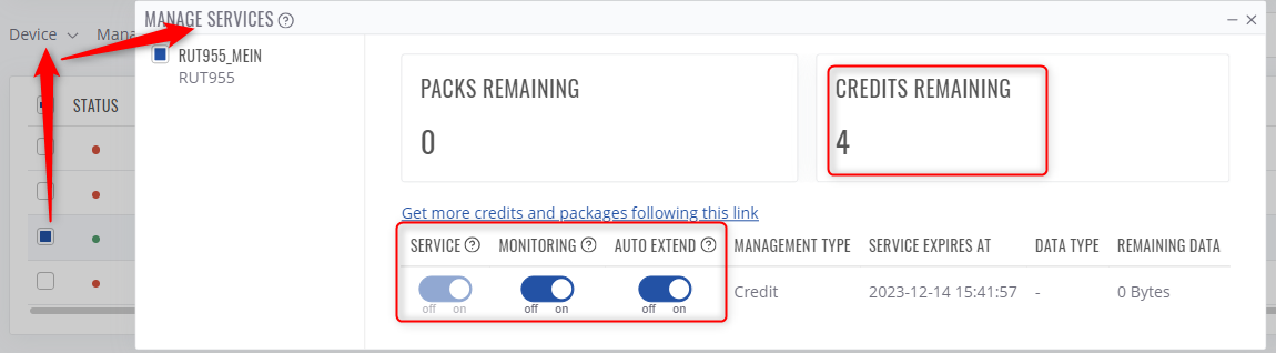

From RMS, check if you have monitoring enabled and that you have enough credits. To do so, select your device in RMS → Device → Manage Services and ensure that ‘monitoring’ toggle is enabled:
Thanks Andzej,
Screenshot below to show that we have spare credits and the monitoring flag is on.
