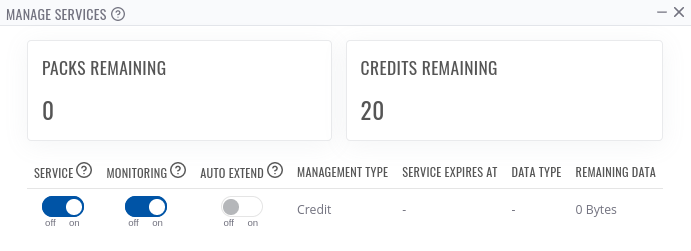

On the devices’s tab on the RM page, “Service” is switched on, and there are sufficient credits remaining:
Any idea why the device is not connecting to RMS/what we’re doing wrong here?
