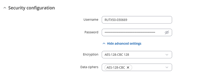

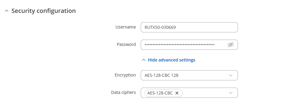

You’ll need to go to SERVICES > VPN > OPENVPN > SOPHOS (select edit) > SECURITY CONFIGURATION and set the required encryption and data ciphers. An example, not necessarily for your ciphers, is shown below.
Thxs for your response and sorry for delay.
I had in my config exact the mentioned entries.
I´m referring to the “deprecated option” log entry, even I have both fields filled in web gui.
However, over the weekend this log entry disappeared.
With regards
Gotthard
