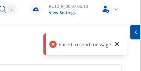

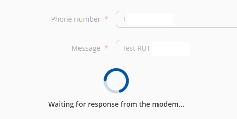

The issue is that after a while it stops working. It’s impossible to send new SMS without rebooting the router. When testing sending a SMS using the mobile utilities web page, the UI hangs followed with a “Failed to send message”:
Capture d’écran du 2024-05-24 13-47-00
Capture d’écran du 2024-05-24 13-47-50

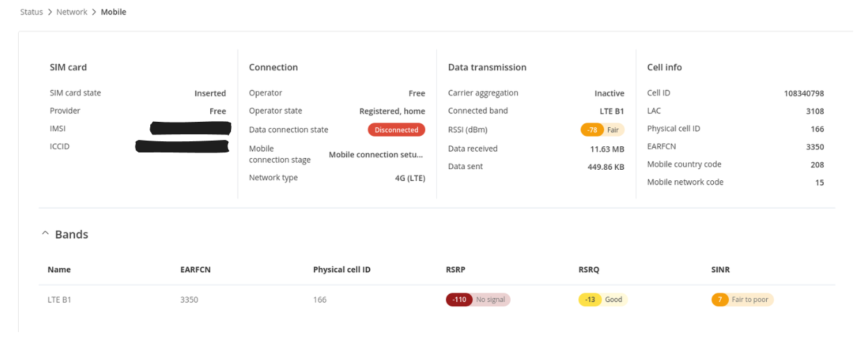

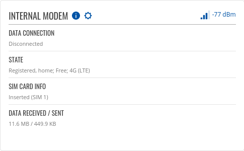

The status seems ok though:

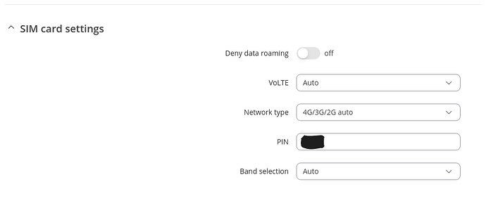

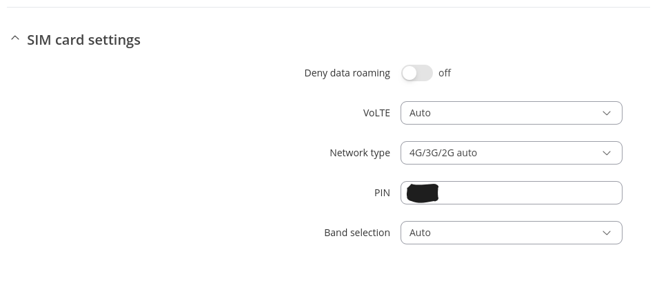

Since I only want to send SMS and don’t want data, is there a simpler config ? Here is the current one:
Can you turn VoLTE off and set Network Type to 3G only for testing purposes?
APN is for sure okay?
Setting 3G only makes sending SMS fail straight away.
APN is set to Auto but seems fine

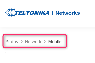

Can you paste a screenshot of

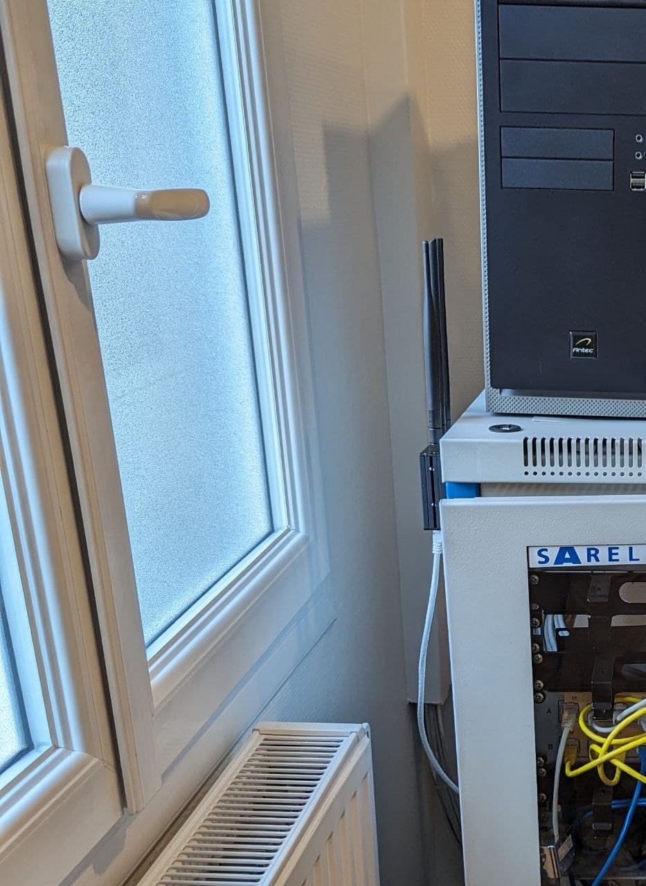

Your mobile signal seems to be weak, which might be causing messages to fail to send. Your data connection appears to be completely disconnected as well. Have you properly attached the antennas or tried moving to a different location where the signal is stronger?
I’ve disabled data because I only want to send SMS. The antennas are properly attached and I haven’t tried moving the router to a different location, no (installed on a client’s site). Is the signal really that weak for only sending SMS?
It seems like the signal is quite weak. You could try moving the router to a different area, preferably closer to a window or a more open space, and then check if you’re able to send SMS messages.
It’s already close to a window:
Also how could this explain that rebooting the router solved the issue in the past?
