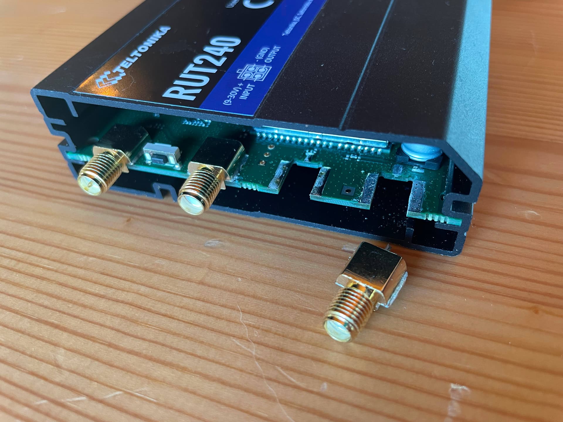

My RUT240 router fell to the floor and the mount for one of the mobile antennas came off. What can be done to fix this? Can one try to solder the mount back on if one is moderately handy with a soldering iron? Or are there some other advise for how to best fix this? Thanks!
Yes, you can solder it back together. Since you mentioned you are moderately handy, this shouldn’t be too difficult. Just ensure that the contacts on both sides do not touch the middle antenna contact.
Hi fredrast,
I did it once on a RUT240 and it still works.
Adjust the temp to 380°C and make sure there is enough
(but not too much) solder.
Timelapse Admin
OK, thanks Marius and timelapsesystems, I will give it a try! :grinning:
