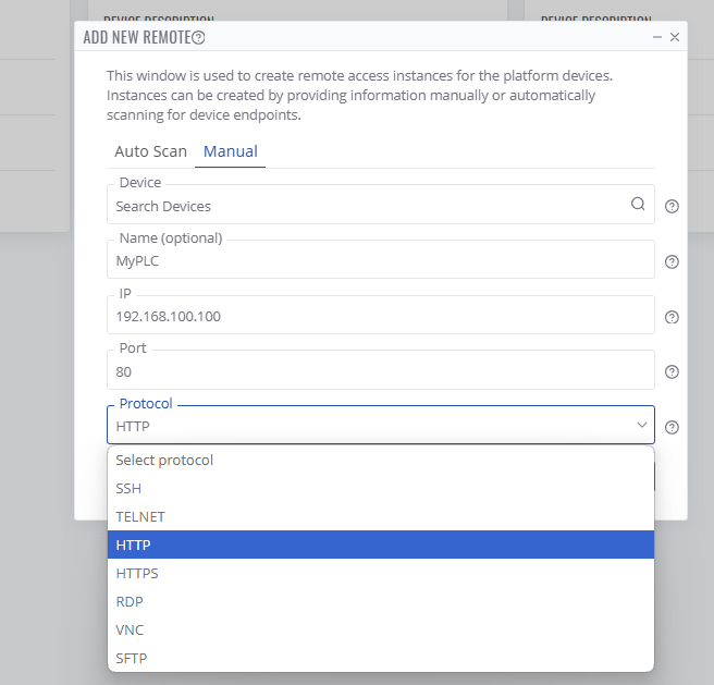

Also, when I log into RMS, the “RMS Connect” section only gives me the options “Remove access” and “Access history” It does not have “Remote desktop” “Remote SSH” or “Remote HTTP(S)”

Regarding RMS Connect, it is still functional. You can access it by navigating to Remote Access and creating a new instance/configuration. This allows you to select the desired protocol, such as SSH, HTTP, RDP, or others from the available options.
