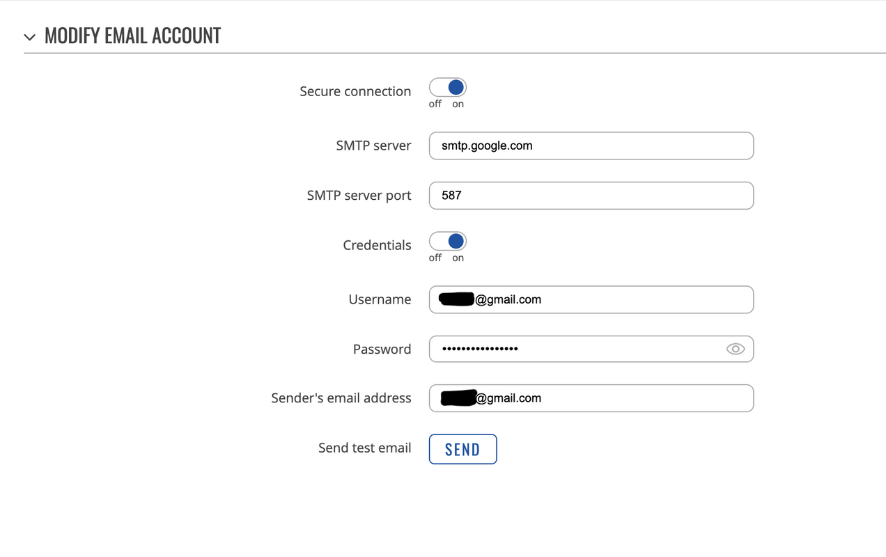

I want to setup event reports via email, but sending the email fails with a gmail address.
I setup a recipient in System / Administration / Recipients / Email users like in the screenshot attached. But sending a test email fails! What am I doing wrong?
The router is RUT240 with firmware RUT2_R_00.07.04.4.

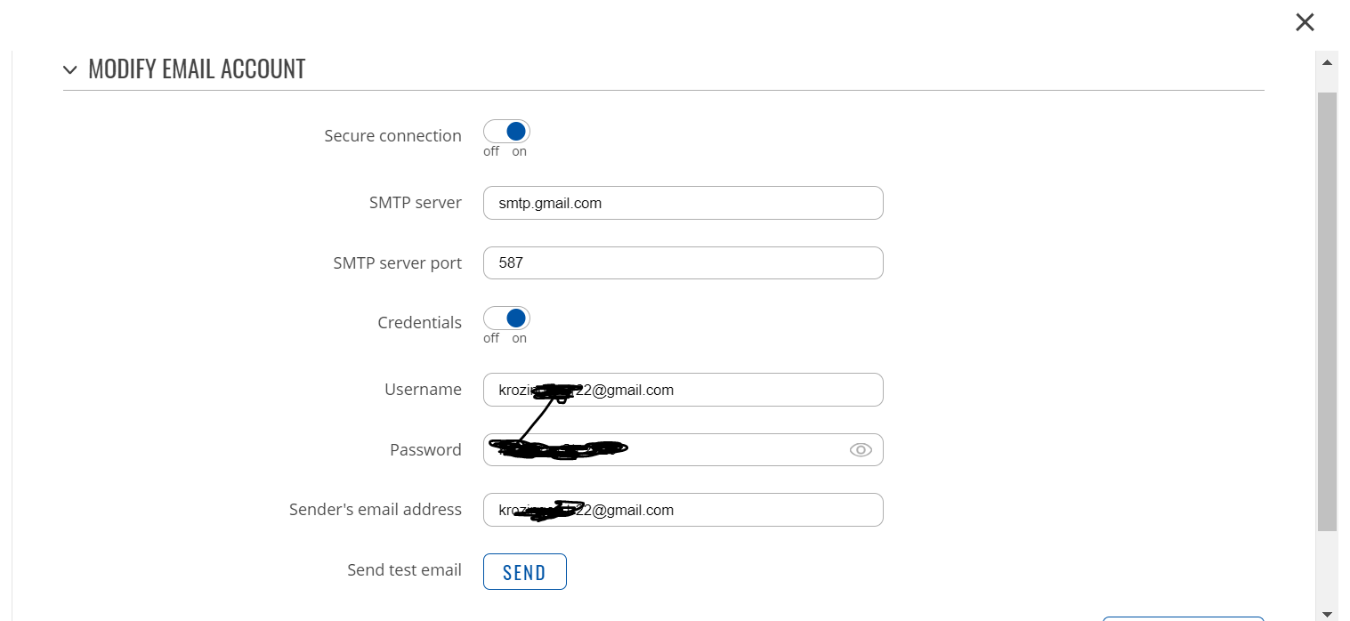

For GMail, you need to enable 2-step verification, as well as create and generate an app password.There is a tutorial available online here.
Thank you! I was able to get it working by following that tutorial. Only that I didn’t have the “Add passwords” field, so I used this link to get there https://myaccount.google.com/apppasswords

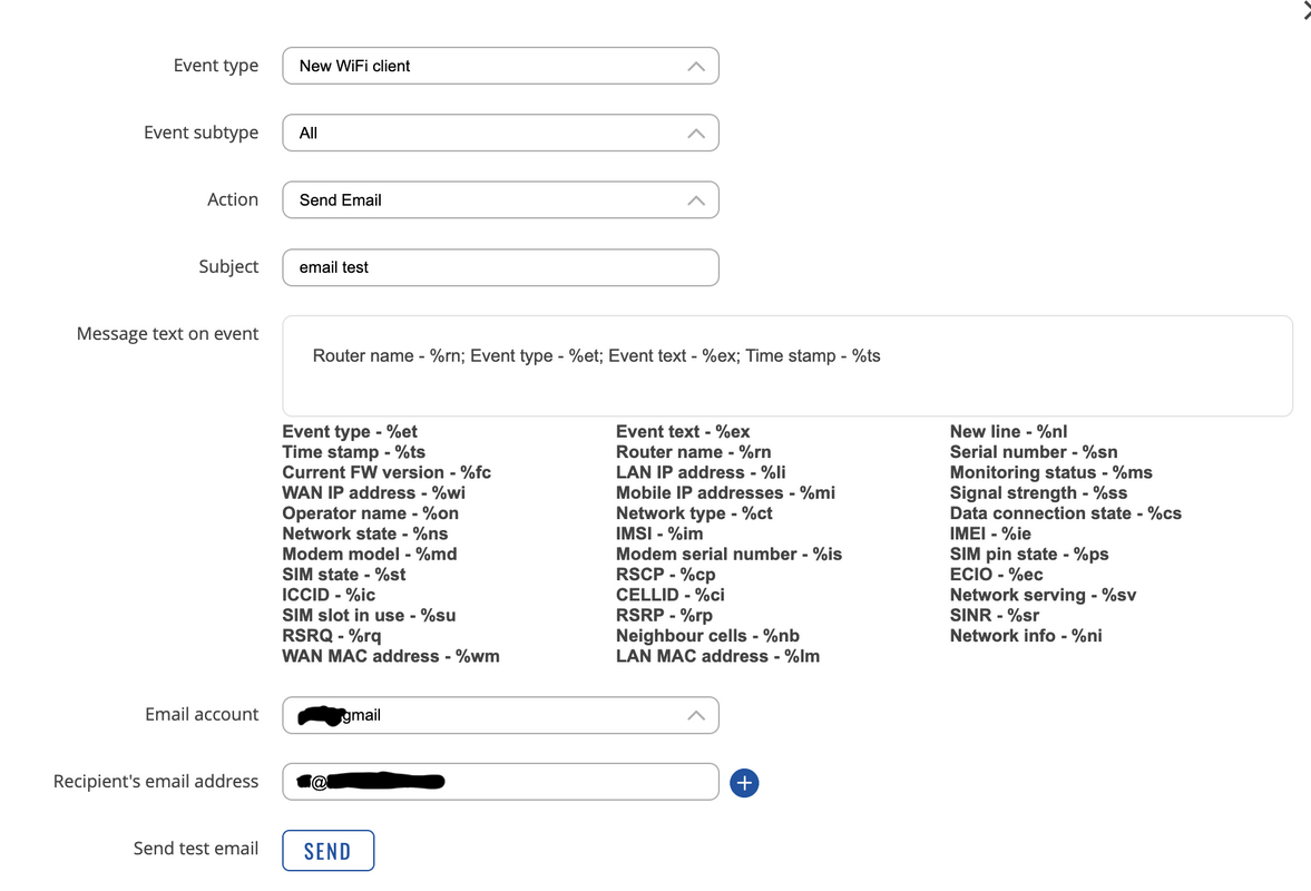

What triggers did you configure? Can you please show screenshots of these configurations?
I have tested and was able to send a test email using Gmail. Could you please double check if you have entered the correct password generated on the ‘app passwords’ page?
I set a notification trigger when a WiFi client joins or leaves.
I have a duplicate rule to send SMS and it works so the device is recognising the event happening.

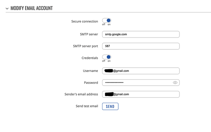

The email account settings are below
I had copy / pasted the App password so am happy that it was correct but just to be sure, I created a new one. No change in behaviour.
I also tried selecting “mail” as the app and “other” as the device when generating App pass in Google, but this also made no difference.
Please try changing the STMP server ‘smtp.google.com’ to ‘smtp.gmail.com’. Let me know if it works then.
:man_facepalming:
Such a simple thing after all these hours of testing! I can’t believe I made such a mistake.
Thank you, yes, that works perfectly.
