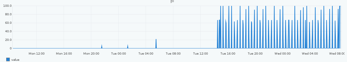

yesterday I’ve updated two RUT240 to the latest firmware (00.07.04.4). Now both seem to have connectivity issues. I havent changed the position of the device nor of the antenna. Mobile connection shows 3 out of 5 bars and ~ -70dBm (LTE). We haven’t had anny issues befor that update.
I’ve uploaded a screenshot where you can easily see when I updated the device ![]()
Anybody having the same issue?
