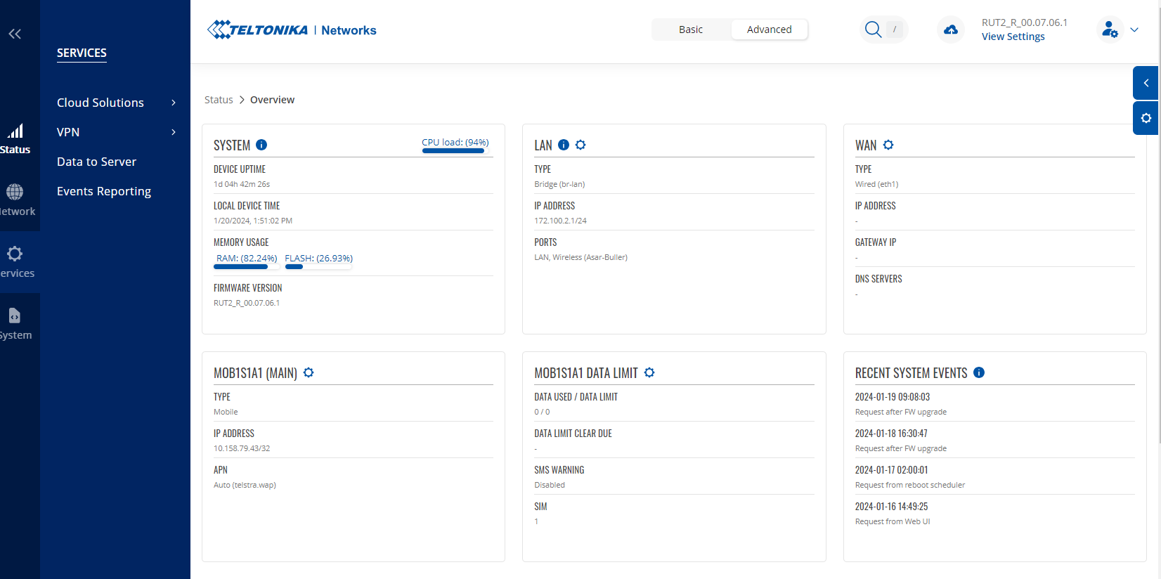

Thanks for the reposne Julio.
I can confirm that I am logged in as an admin user and have the advanced mode selected. I am using Chrome browser updated to the latest patch.
I don’t use RMS as I have only 2 routers to manage.
Here’s a screen shot of what I’m seeing. Note in particular the very limited number of services showing.
Hello. Since you currently only have remote access to the device, I won’t advise trying to fix it until you are able to do so on-site.
I’ll advise trying to locally reset the router to its factory settings and then reconfiguring it.
I hope this resolves the problem.
If not, kindly get in touch with your sales representative to initiate a support ticket.
Best regards!
