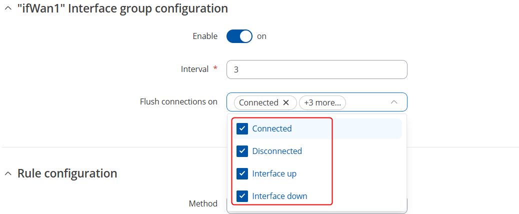

If that is the case, could you try selecting all of the “Flush connections” options (shown in the screenshot below) on the Starlink failover interface to see whether it makes any change?

If that is the case, then try enabling the “Flush connections” option on the failover’s wan (wired) interface.

We have now been able to test it with “Flush connections” switched on. Unfortunately, the automatic reconnection with the Startlink antenna is still not working. Do you have any ideas what else we could do?
