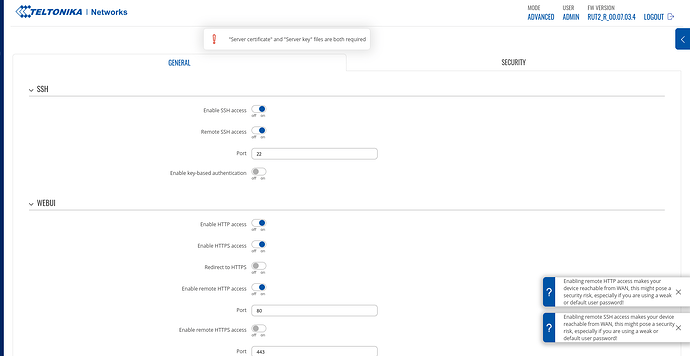

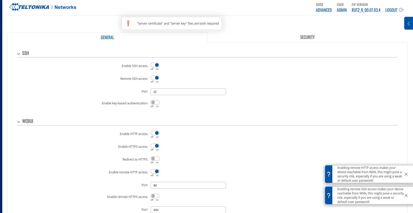

Perhaps curl`s error was created by the turned off remote http access, in the access control,
But, i can not turn on remote http access because my certificates and server keys are invalid as I illustrated in the screenshot.
Does anybody have a hint to solving this problem?
If I need more context, please write that i need extend.

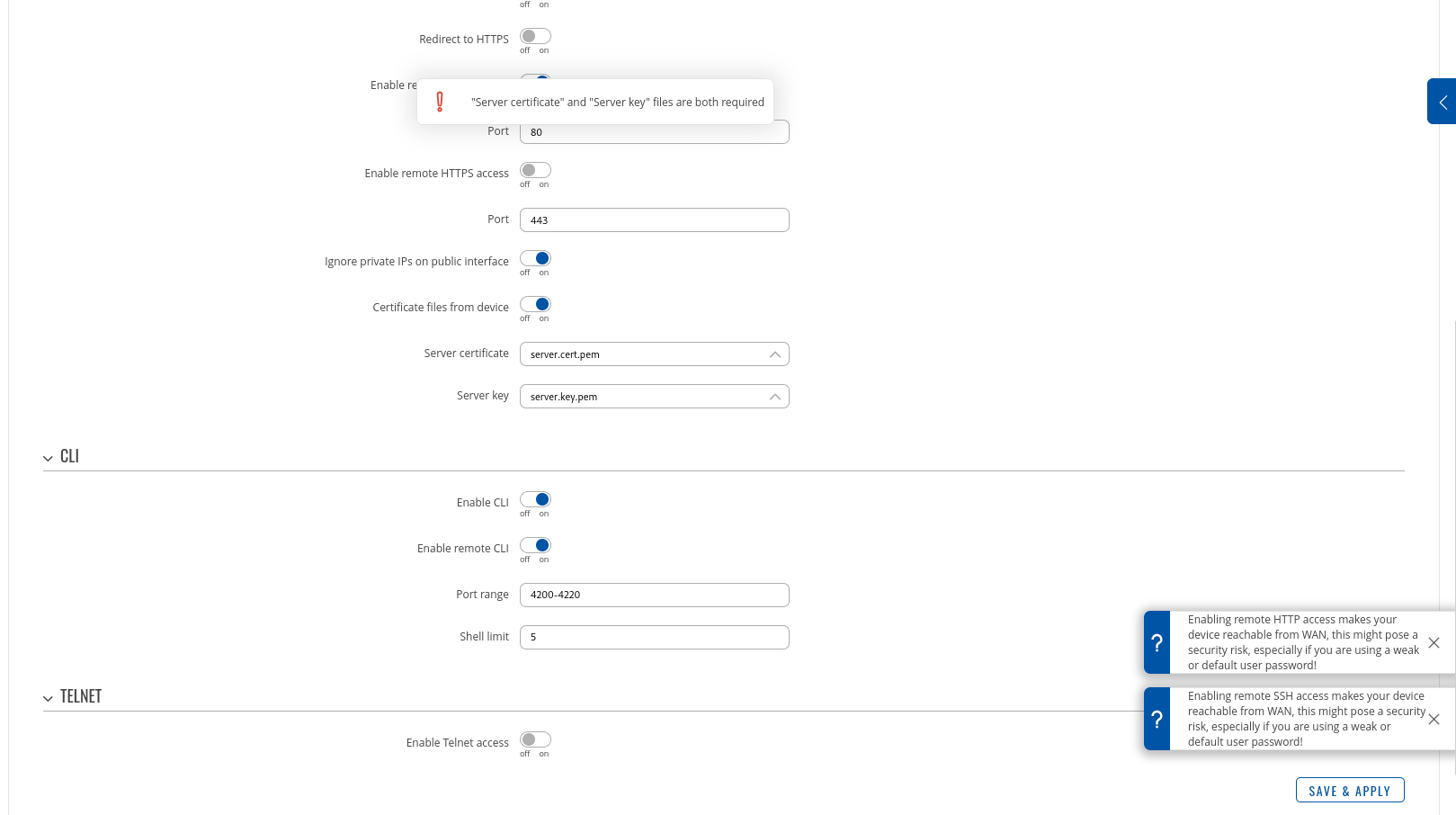

To clarify a couple of things to better troubleshoot this:
  • Could you please confirm whether the server certificate and key are selected in the relevant fields under System → Administration → Access Control HTTPS settings?
    If they’re missing, you can generate them on the System → Administration → Certificates page. Moreover, instructions for creating a server certificate and key are provided here, after which they should appear in the selection dropdown, allowing you to enable remote HTTPS access if needed. More useful information on certificates can be found here:

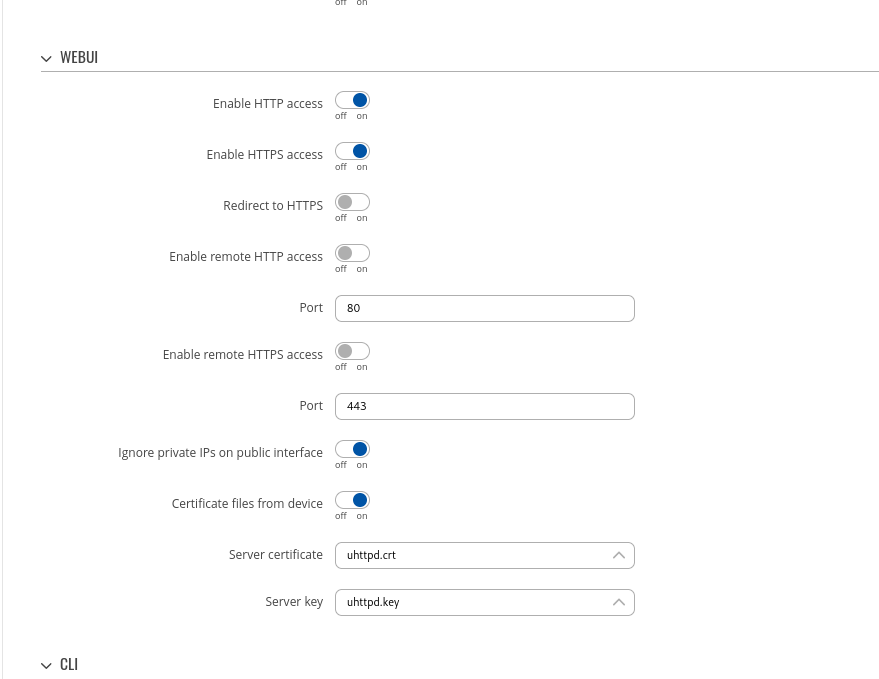

Thank you for your answer,
I set a new ca and server key, but anyway, it does not work it writes like in the past, and after reloading the page, keys and certificates change to default.

Thank you for your update.
Since the RUT230 is an EOL (end-of-life) device, and considering the behavior you’re experiencing, where certificates and keys revert to default after a reload, there might be an issue with the current firmware, possibly due to misconfigurations or internal conflicts.
In this case, I recommend flashing the latest available firmware (7.03.4) via the bootloader menu for a clean installation. Instructions for this process can be found here:
