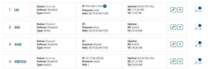

RUT230:

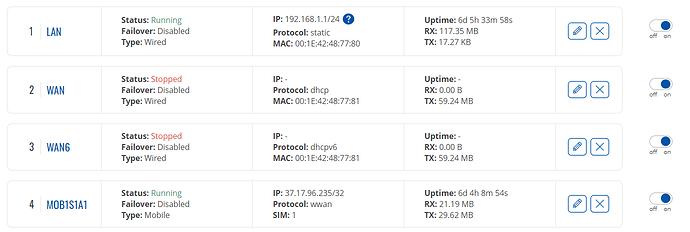

RUT950:
on RUT950 its same on RUT230:

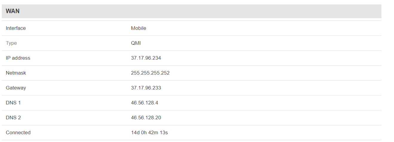

on my PC:

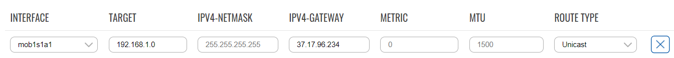

It’s not working. Maybe I made a mistake somewhere?

It seems there might have been a misunderstanding, as in your provided screenshot with network interfaces, there is no active wired WAN connection. Let’s ensure that your RUT230 is properly connected to your RUT950 via an Ethernet cable. Once connected, please retry the routing test and let me know the results.
