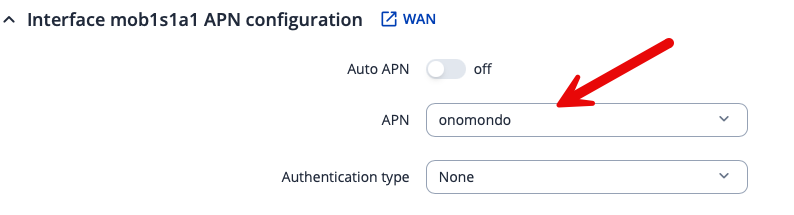

Hi Again,
I am also trying to read / set the APN through the API. But I am a little confused. When I try to GET it from a RUT200 where I have set it manually it does not return that APN - but only the rest on the list:

Greetings, @sb-kleenhub ,
I hope you’re doing well,
What you are seeing is the expected behaviour of the /api/modems/apns/status endpoint. This endpoint queries the APN database - a pre-loaded list of carrier APNs that the device uses for its Auto APN feature - rather than the active APN configuration of your mobile interface. Because of this, it will return carrier-matched entries (in your case, T-Mobile’s pre-loaded APNs) but will not reflect the APN you have manually set on the interface itself.
To read and set the APN that is actually in use by the mobile connection, you need to interact with the network interface configuration endpoints instead. Specifically:
• GET /api/interfaces/config - returns the current configuration of all interfaces, including the active APN set on your mobile interface.
• PUT /api/interfaces/config/{id} - allows you to update the configuration, including changing the APN, disabling Auto APN, and setting credentials.
Please make sure you are referencing the documentation for your specific device model and firmware version at:
As endpoint paths and available parameters can vary.
A couple of additional tips:
• If Auto APN is still enabled on the interface, the manually set APN may be overridden. You will want to ensure Auto APN is toggled off when setting a custom APN via the API.
• For further context on how Auto APN works and its interaction with manually configured APNs, the Teltonika Wiki article is a helpful reference.
Please let us know if you run into any issues or need help identifying the correct interface ID for your device - happy to assist further.
