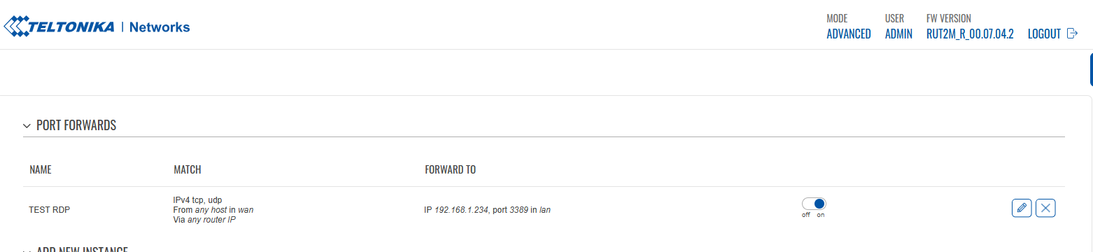

I have a RUT200 device with a SIM card, and my PC is connected to the RUT200 via Wi-Fi. I am trying to remote desktop (RDP) into the PC from a remote location, so I have forwarded port 3389 from the public IP address (the SIM card’s address) to the private IP address (the PC’s address). I have tried all the suggestions from the older post, but nothing has worked for me.

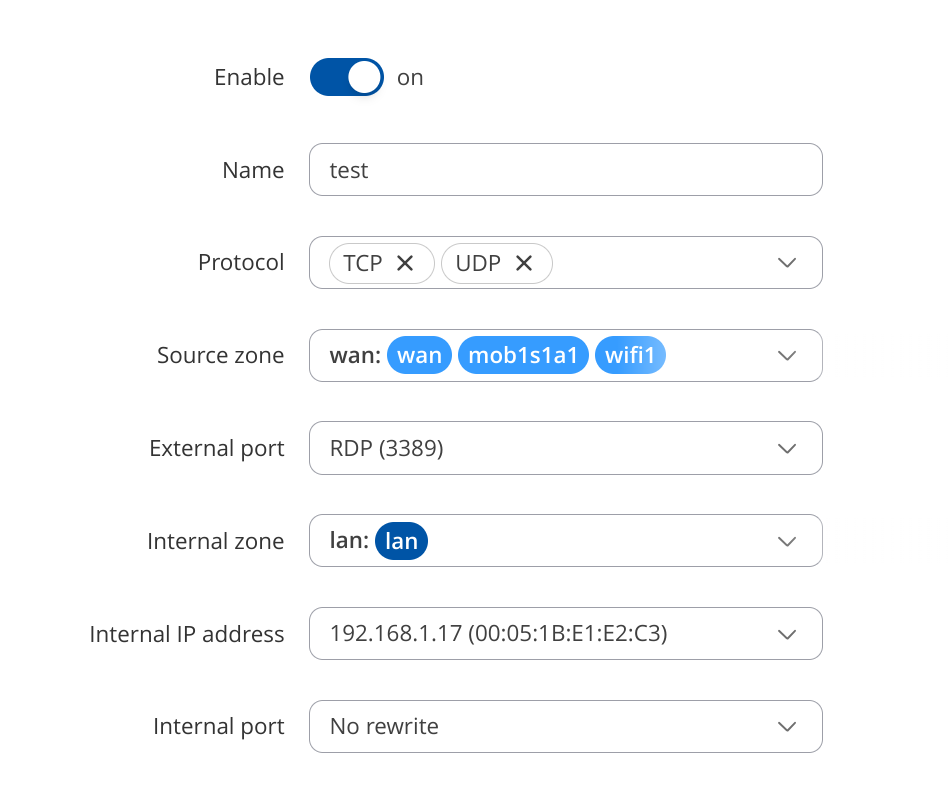

Hi…
Checking here…
Sample…
Updating…

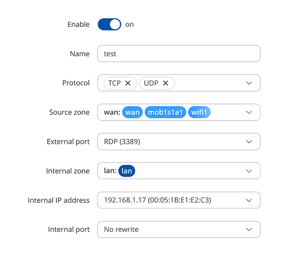

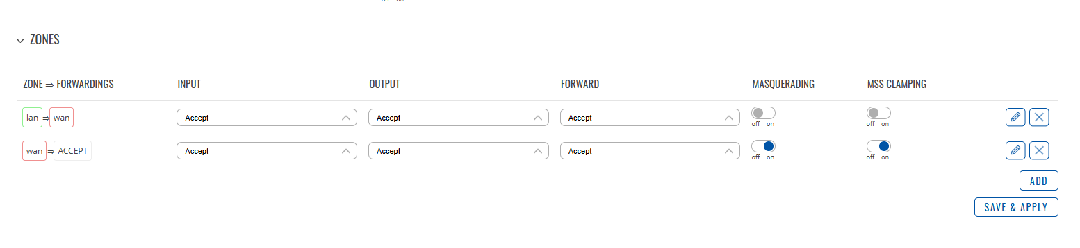

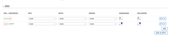

Just… a few screens to you do a test… Maybe we (you and me) are do something wrong…
I change forward to accept

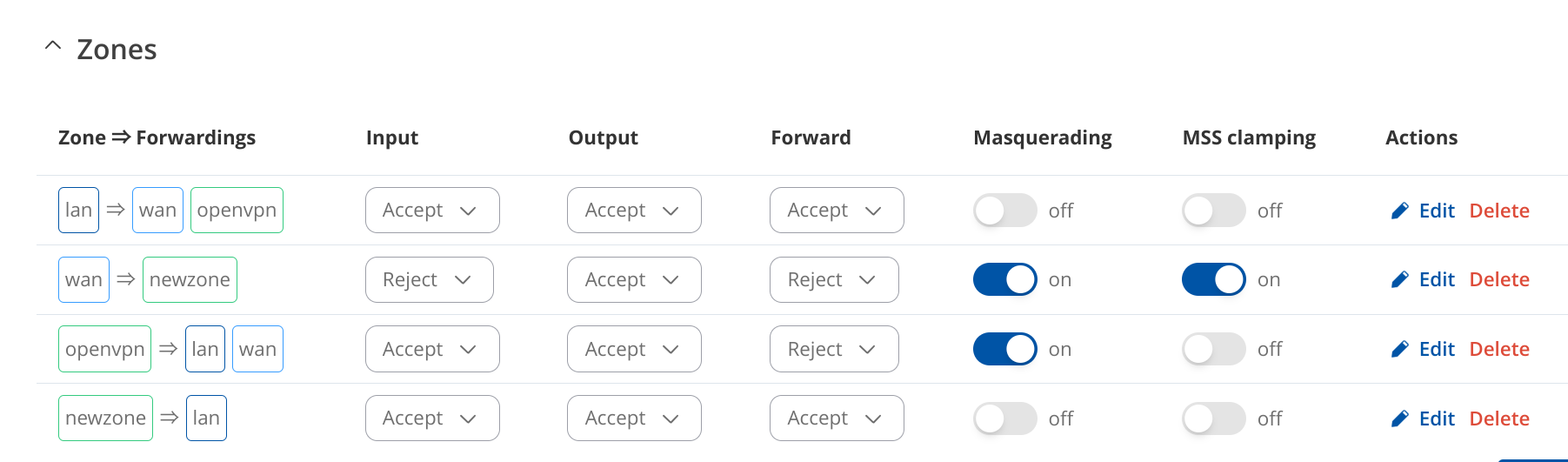

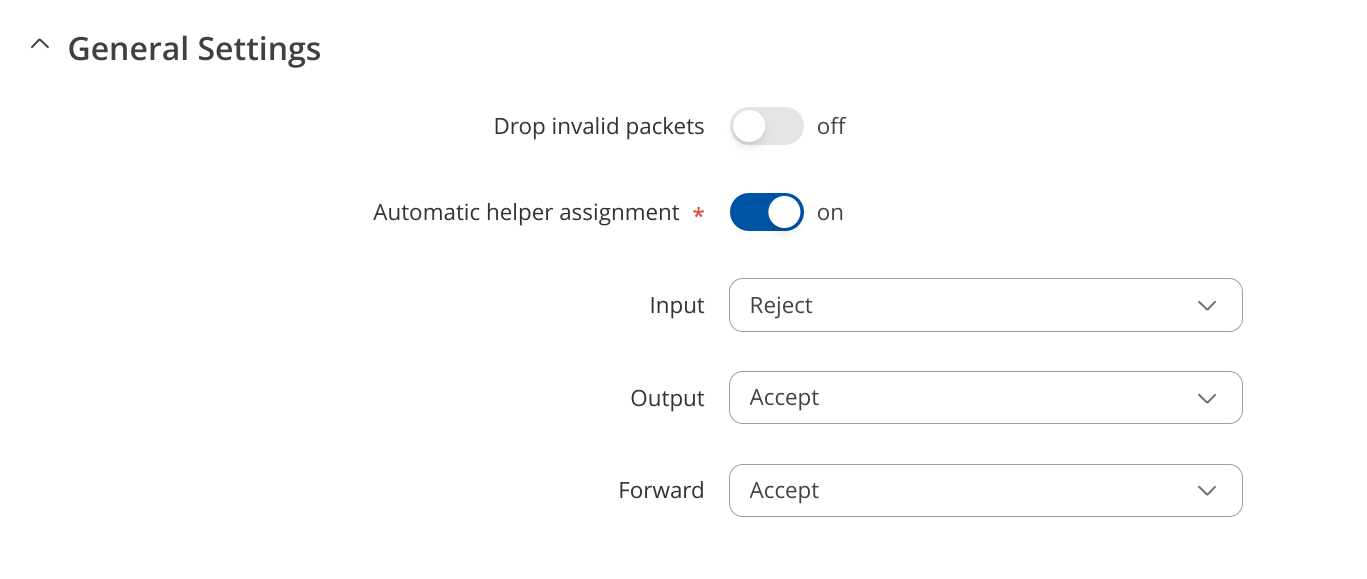

I disable software off loading

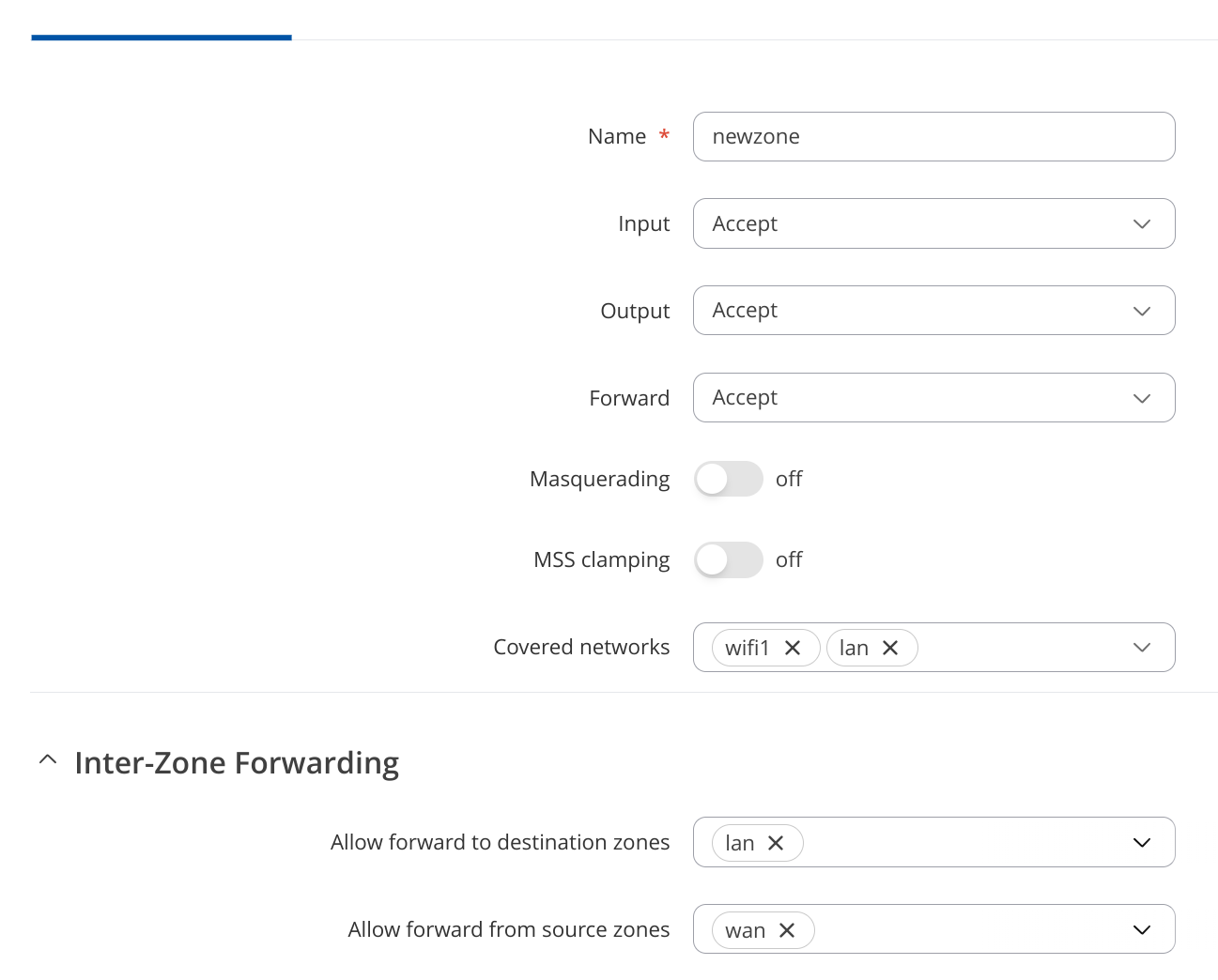

build newzone
newzone in details… I am using wifi1 as wan
so… add your wan at covered networks
