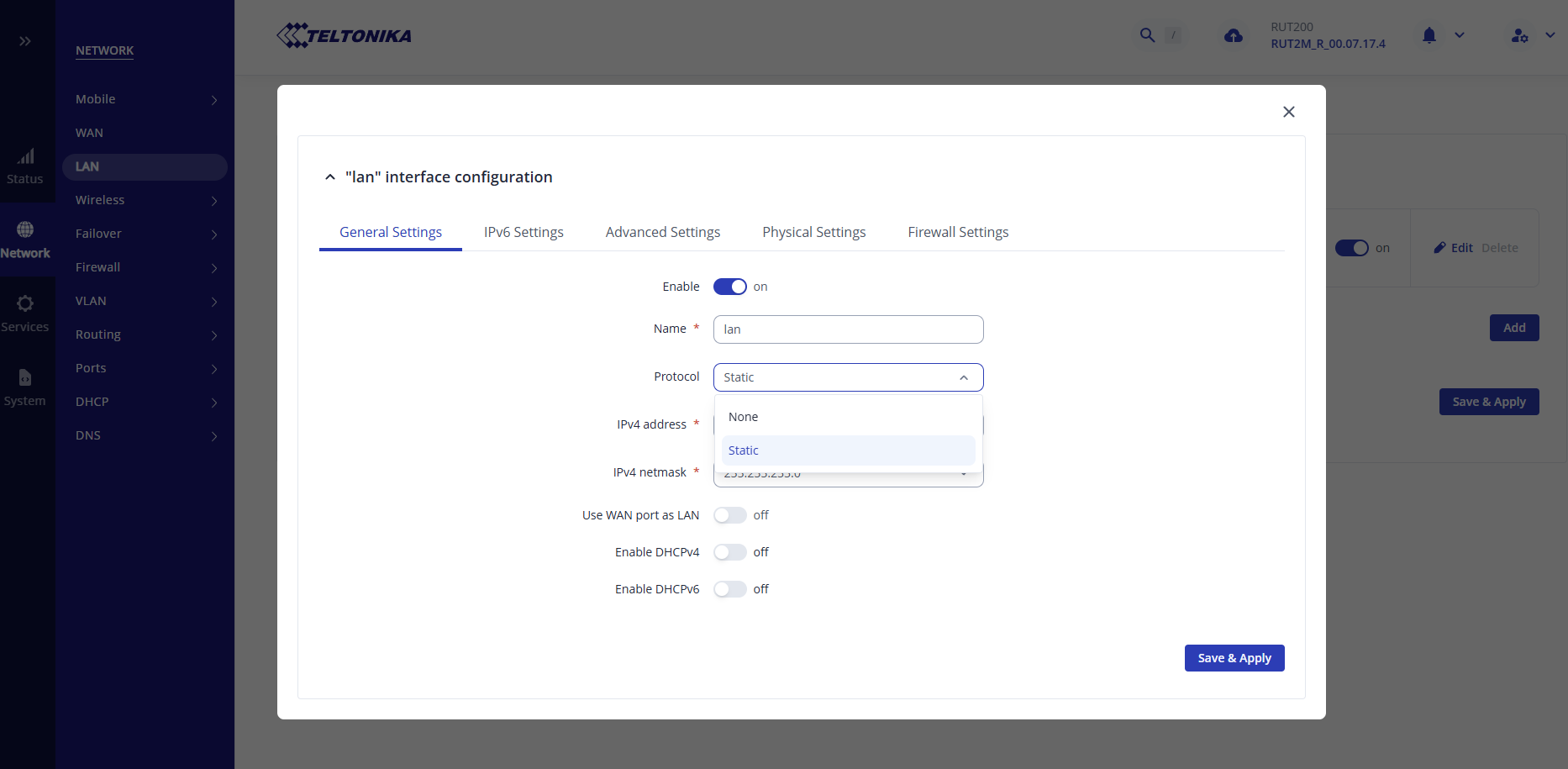

Hi
why is there no option to select dhcp option
i have configured the settings for mesh, but i am not able to select dhcp for the lan interface
main mesh node rutx50
mesh node 1 rut200
i can see that the rut200 have received ip via dhcp on the wifi network so things seems to be ok
but i would like to verify that this setup is valid.
