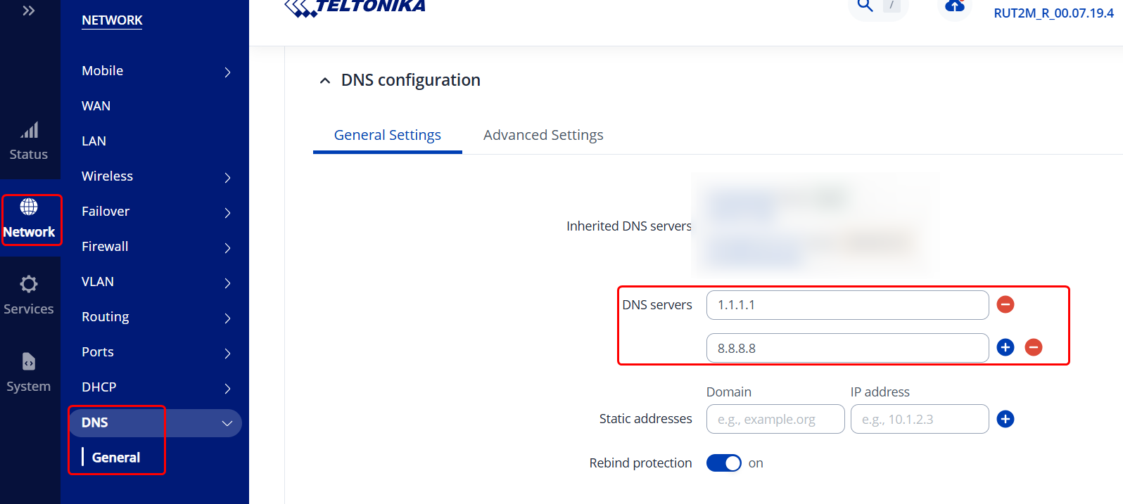

Could you try forcing the 8.8.8.8 and 1.1.1.1 DNS settings by going to Network → DNS → General and adding them like so:

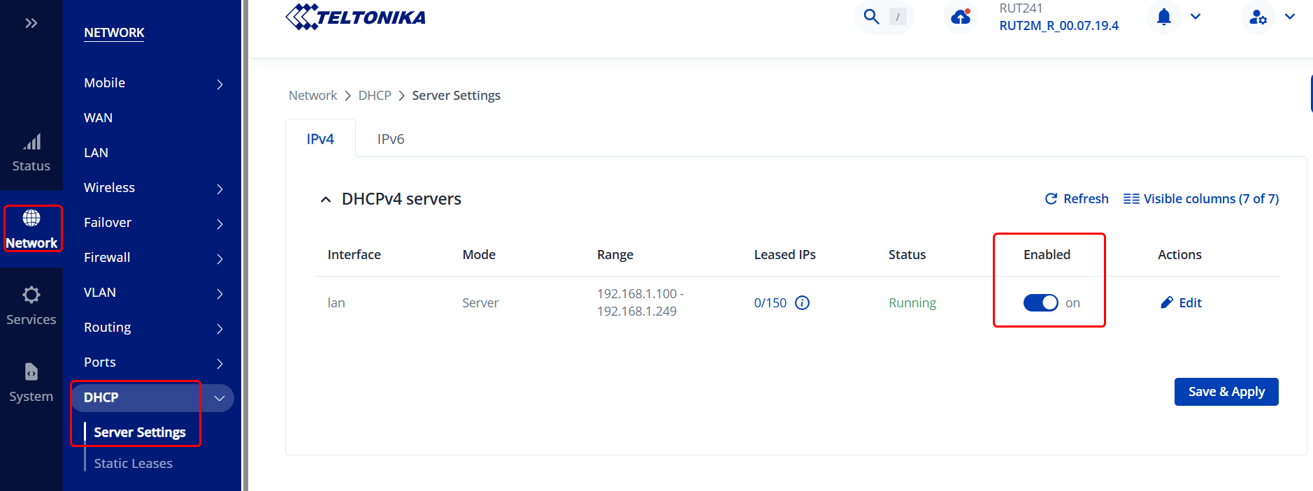

Make sure to also ensure that the DHCP server is enabled on your RUT device:

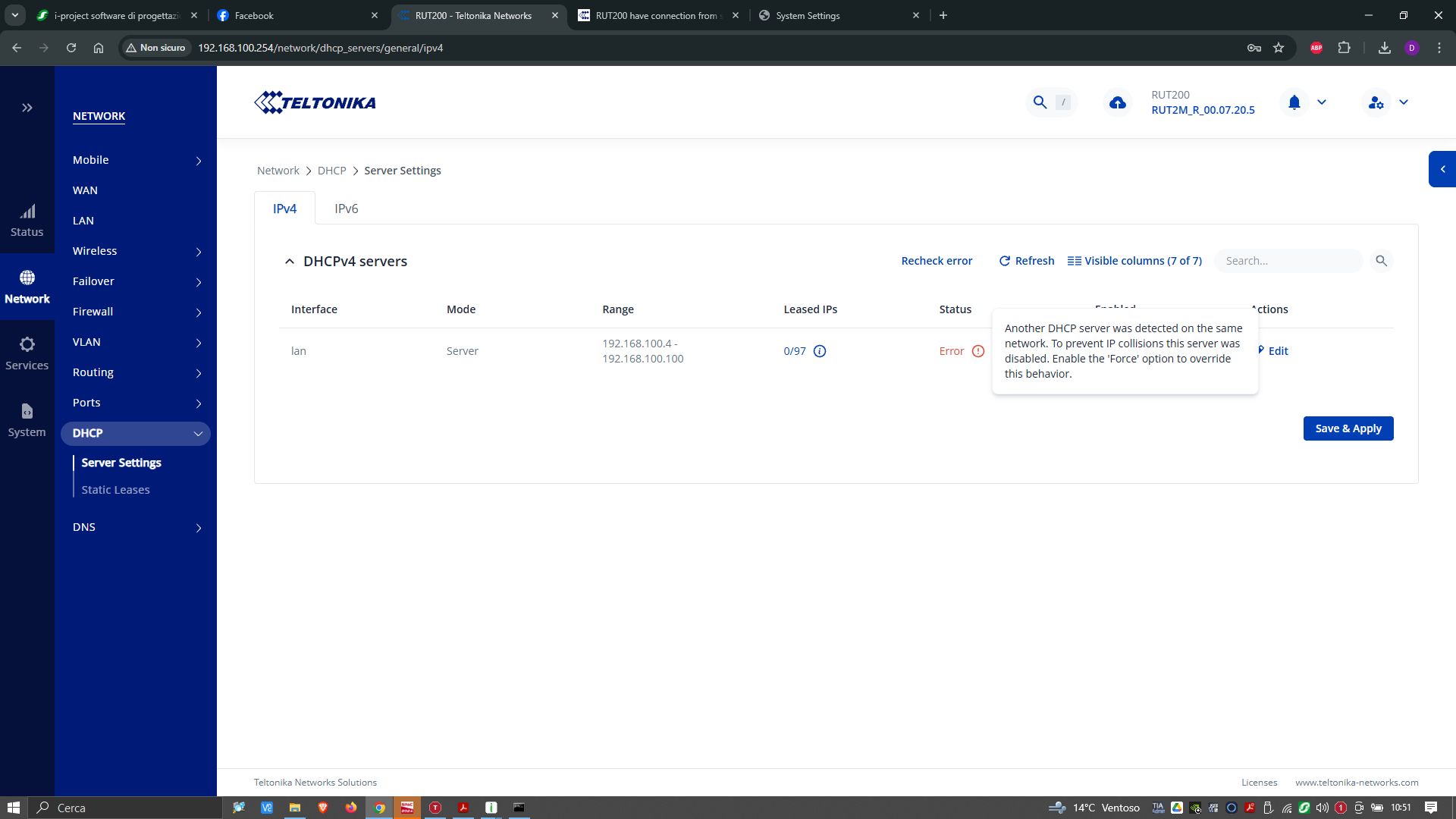

i can’t enable the dhcp server, but all the devices under the lan have static ip

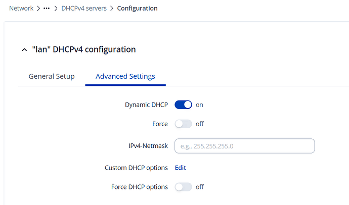

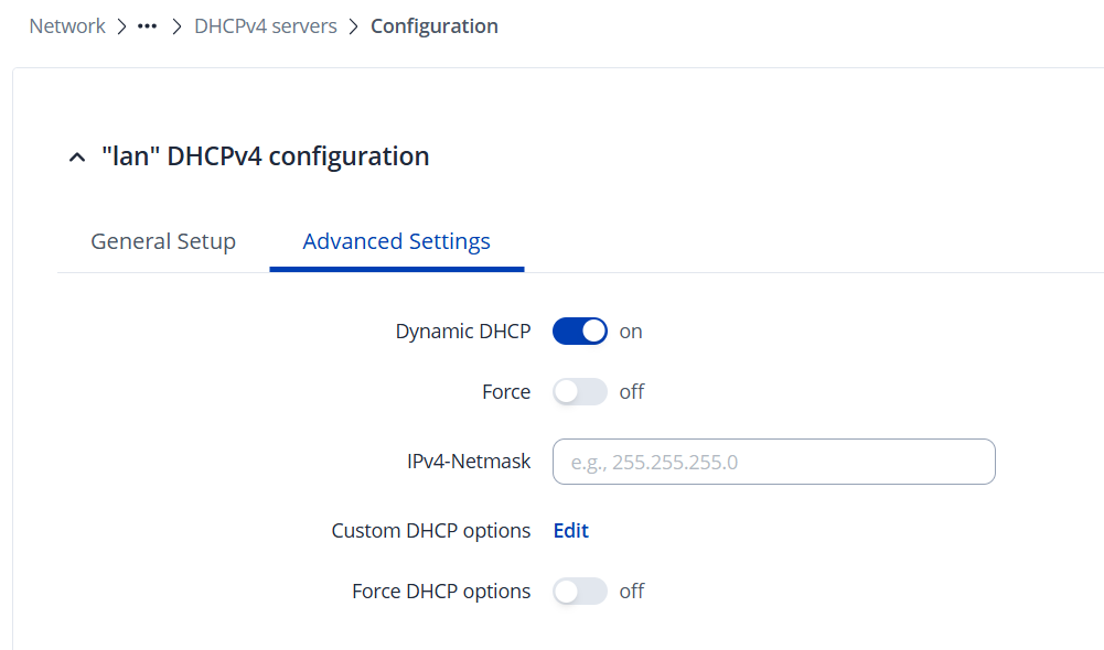

If the DNS options weren’t enough to resolve the issue, then this will be the cause (the DHCP server I mean) - as to why this is happening, it says here that there’s another DHCP server somewhere? Do you perhaps know whether one was configured somehow somewhere? Could you try enabling the “Force” option as the message suggests?
One more thing is - ensure your HMI is connected to the LAN port, and not the WAN port; Very common mistake.
I force and the server is running. But nothing change… the wan is disable

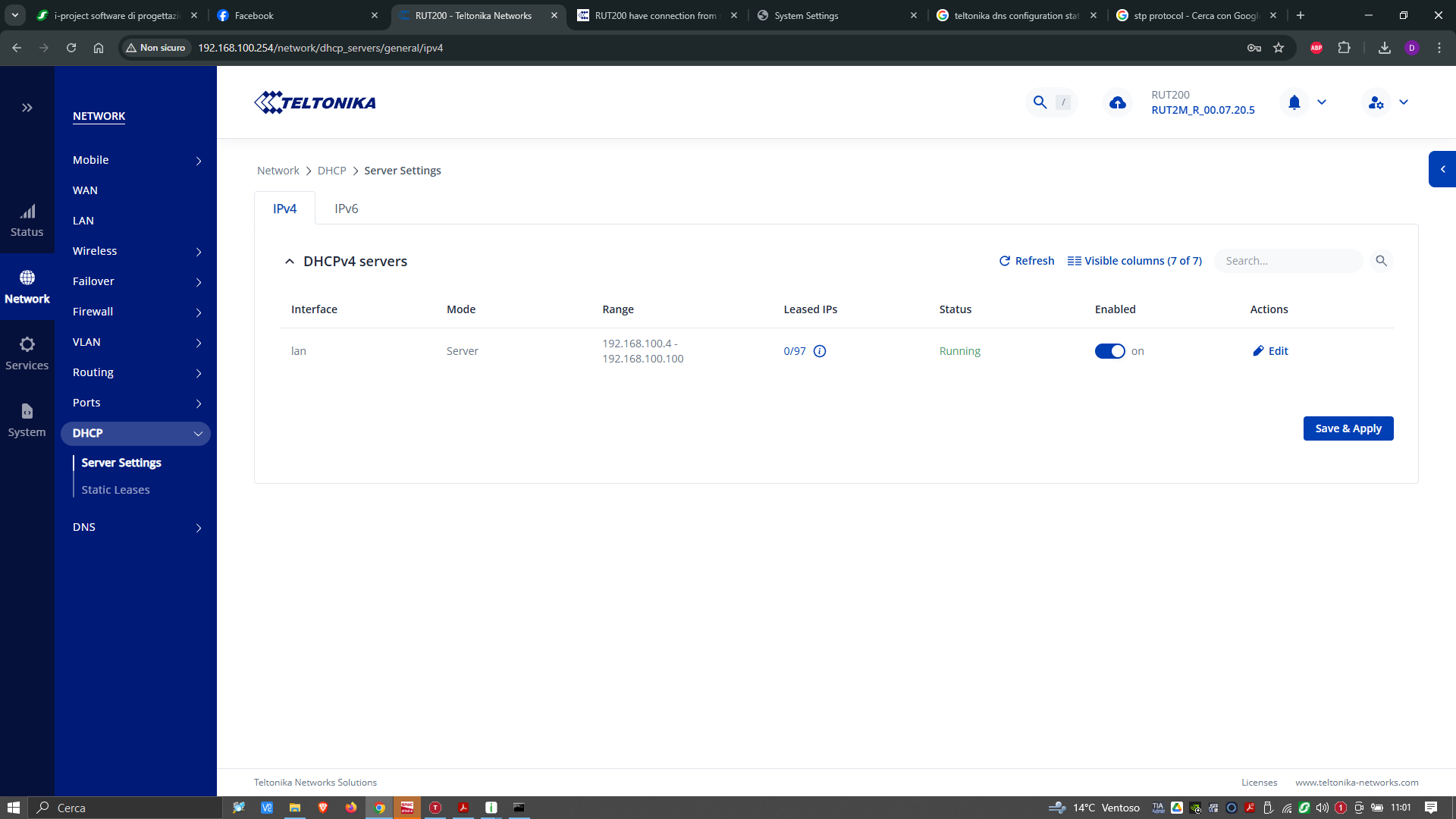

Regarding your situation - are you certain that your HMI is reachable from the router itself? From the Leased IPs section, I can see that it’s at 0/97, which would tell us that there’s no LAN devices connected at the moment.
