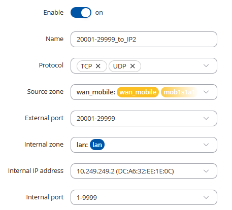

how can i forward multiple external ports (eg. 20001-29999) to multiple internal ports with translation (eg. 1-9999 => means minus 20000)?
Translation of one port i got done; multiple to one also.
Thanks vor your help.

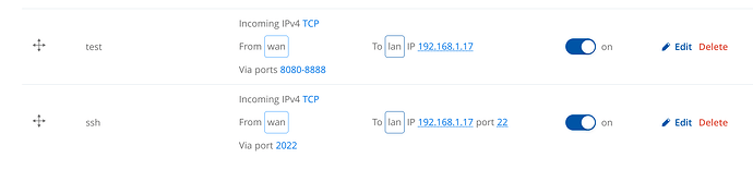

Test here (RUT240)
  • WAN (8080 > 8888) works with " no rewrite " to LAN
For rewrite WAN TO LAN
Only works in my device, building rule for each data traffic between wan and lan
Sample…
With no rewrite it works for me too, but that dont help.
I can’t make a rule for every port, this would be too much rules.
What means Port range in the help (screenshot)? How do i have to use it? Is there an example with this parameter?
In other router/firewalls this should go like my example. Could this be a bug?
