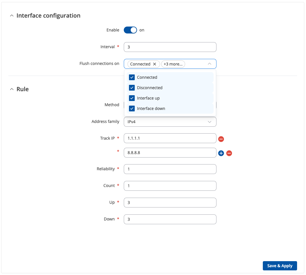

The problem I have is that when the fiber fails and goes to cellular, it doesn’t always switch back automatically
The fiber connection has a public IP when it works and when it fails, it gets 192.168.0.2 from the fiber router. When that happens, I need to go into the RUT200 and switch the fiber interface on and off, then it gets its public IP. I do have flush enabled on both connections.

Hi Martynas,
All 4 are already enabled on both connections.

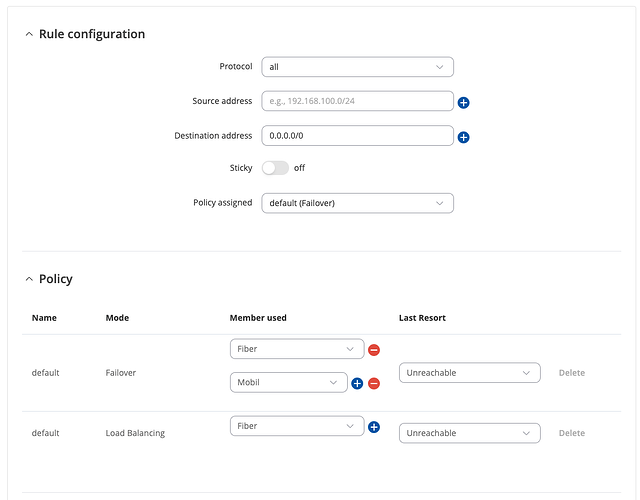

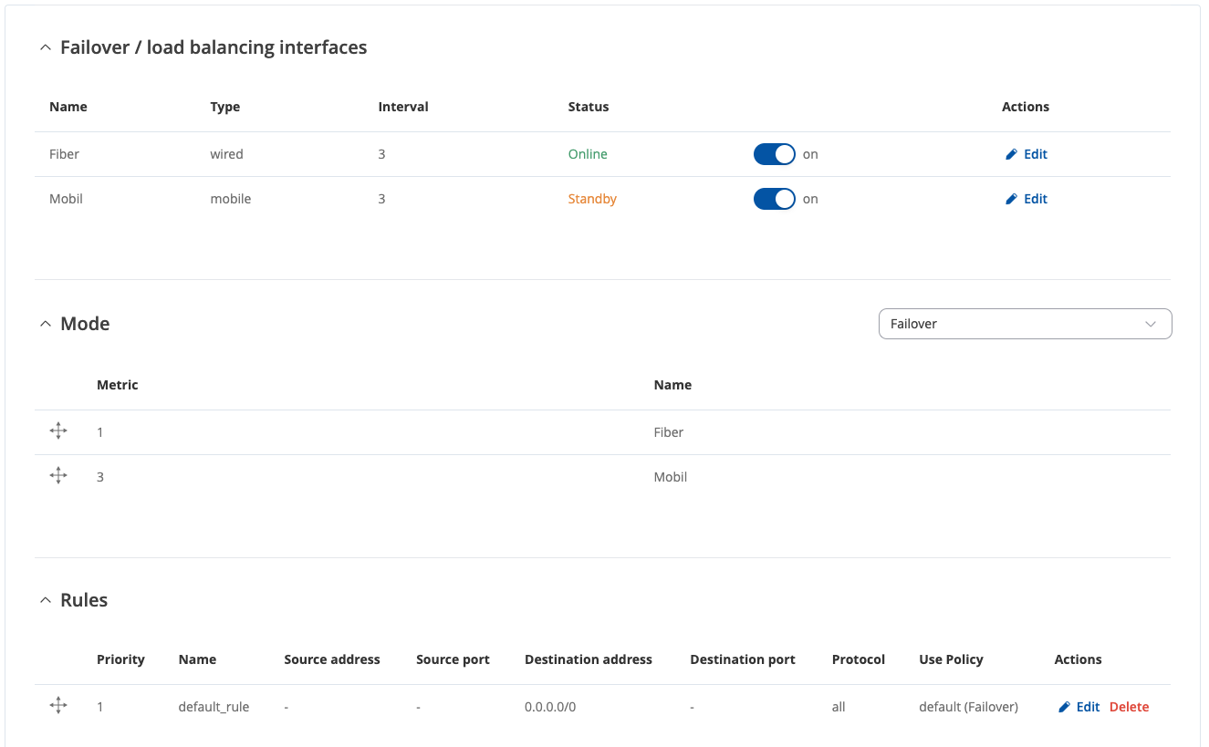

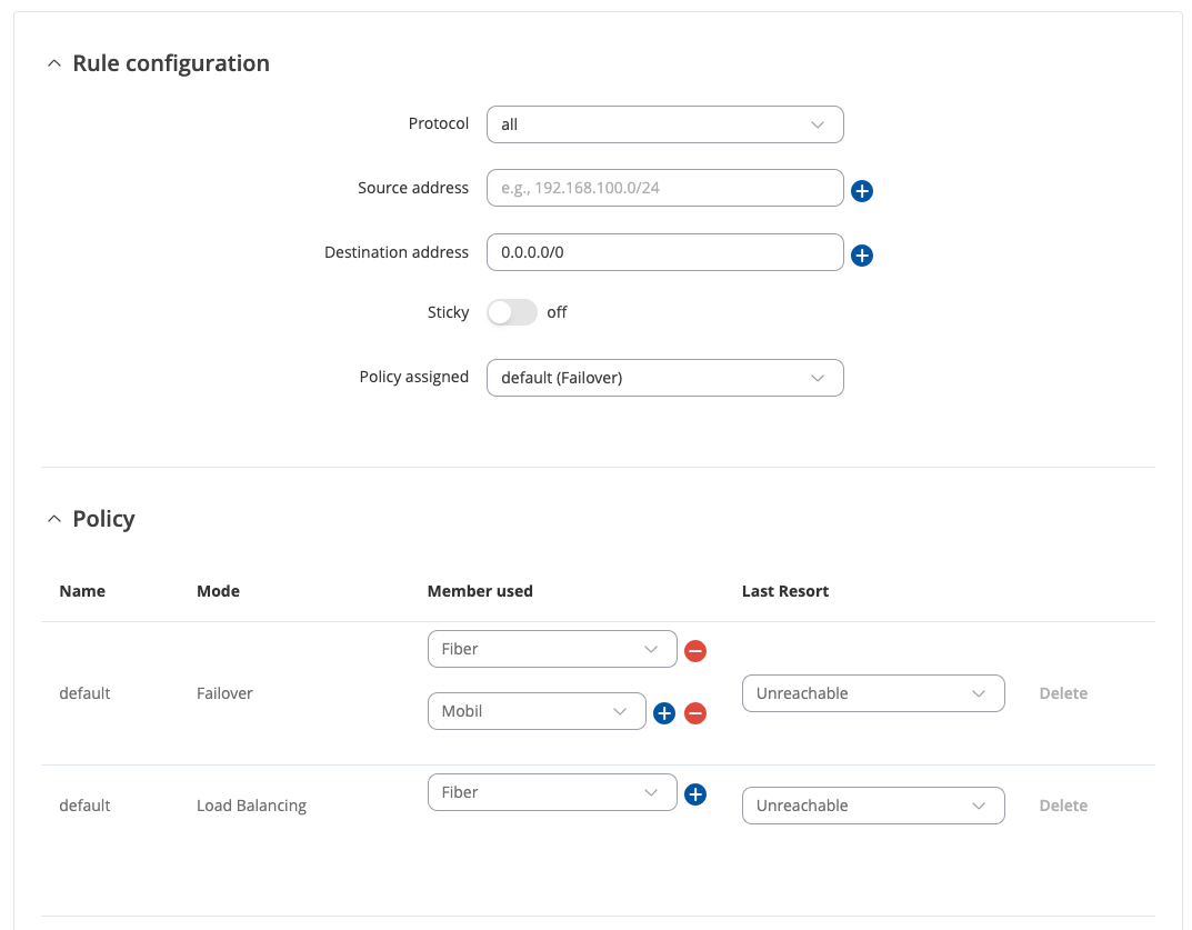

Thank you for the update. Could you kindly provide a screenshot from the Network → Failover page? This will help to further investigate the issue and ensure everything is configured correctly.
Sorry for the late reply. Forgot about since it has worked since then, except today when it failed to switch back.
Here are the screenshots
