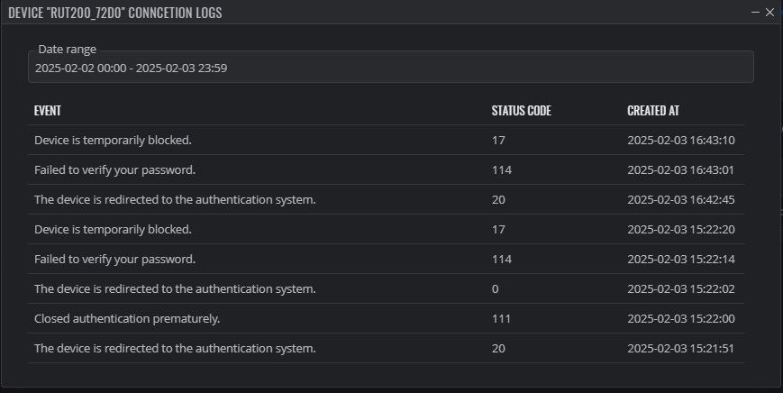

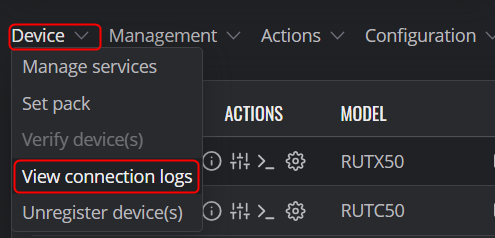

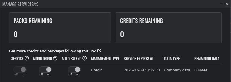

Could you please confirm that your device credit has not expired? Additionally, could you provide a screenshot of the device connection log? You can obtain this by selecting your device and choosing View connection logs from the Device drop-down menu:
My one month free trial credits will expire on the 8th February 2025

Thank you for providing more details.

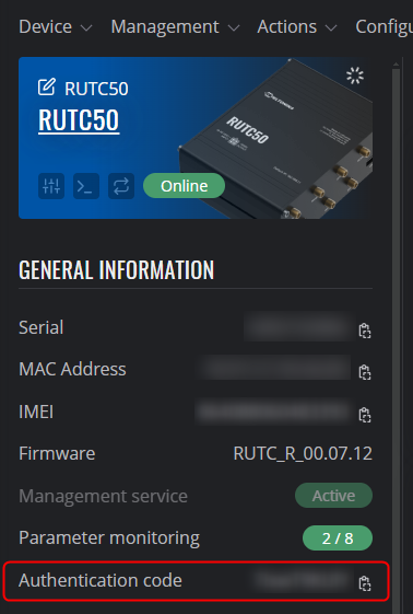

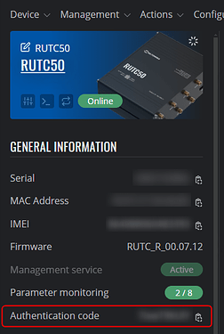

Could you please confirm if, at the end of the device registration, you saw a displayed authentication code? This code should be inserted into your device’s WebUI under Services → Cloud Solutions → RMS Authentication code field. Alternatively, you can also view the code in RMS by navigating to Device Details:

And my credits are over

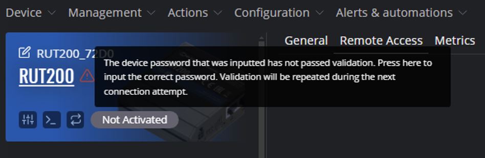

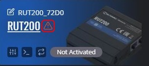

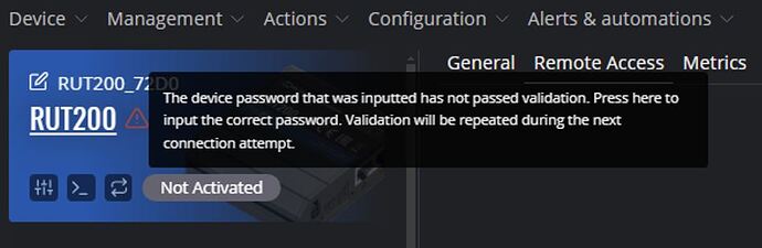

If the issue still persists, could you provide the message displayed when clicking on the attention icon:

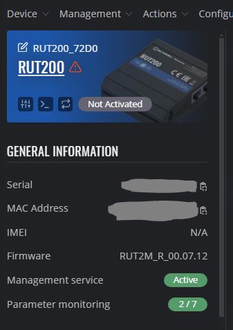

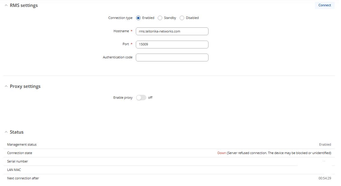

I can access the device UI but I get this error “Down (Server refused connection. The device may be blocked or unidentified)” after pressing connect it loads “connecting” then this error shows up
And this is the message I get from the attention icon
