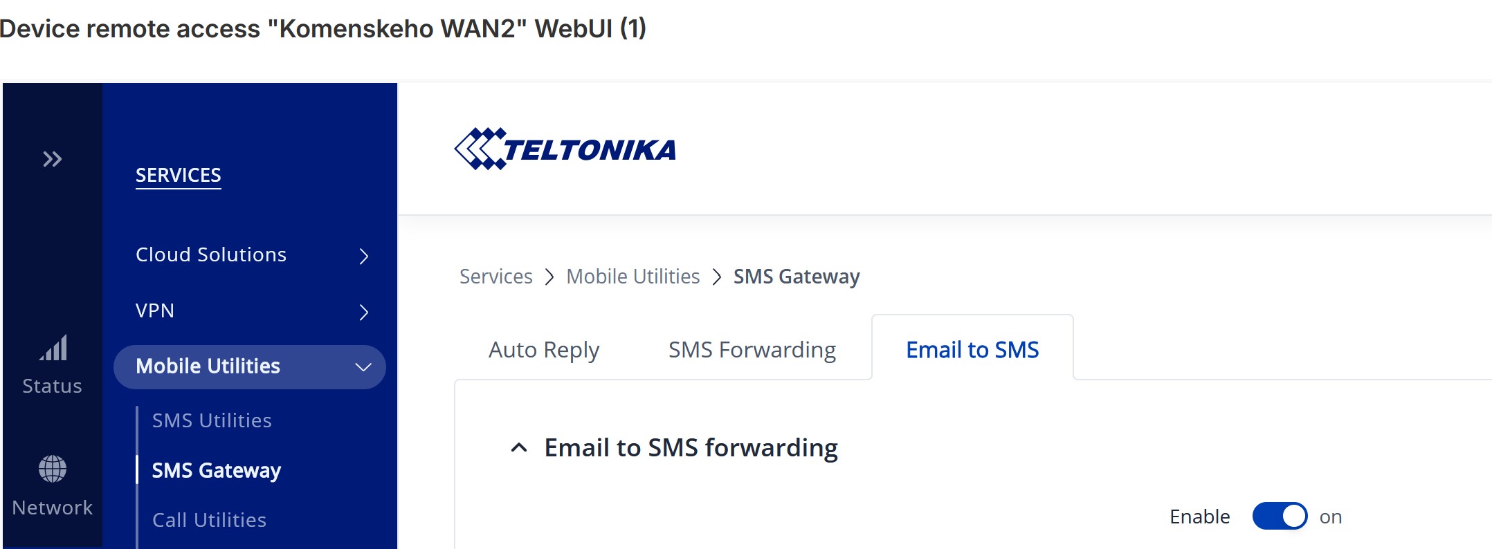

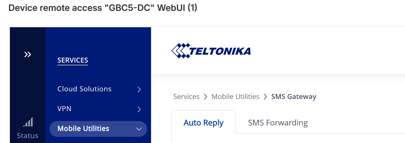

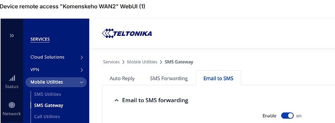

I have two RUT200 routers, one of these I use for EMAIL to SMS feature and want to configure the second one for different customer with same feature, however on the second router, this feature is not visible. Anyone facing same issue? I’m somehow lost, why this is not working…

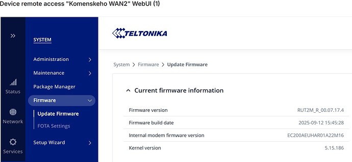

Router 1 - firmware version - EMAIL to SMS is OK
Router 1 - Email to SMS service is visible

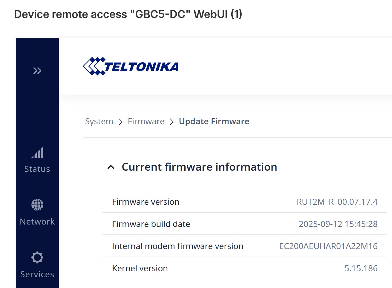

Router 2 - firmware version - EMAIL to SMS NOT OK
Router 2 - Email to SMS service is NOT visible

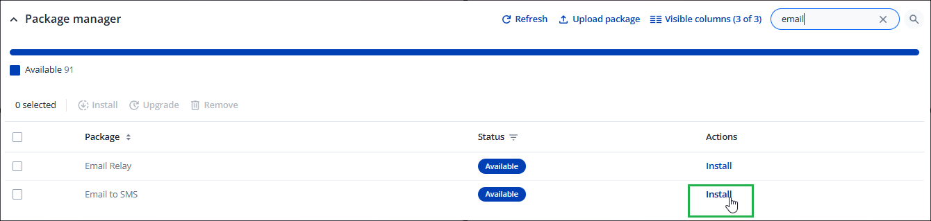

This functionality needs to be downloaded to the device separately, as it is not included in the firmware by default.
Navigate to the “System → Package Manager” WebUI menu, and download the “Email to SMS” package to your device. Once this is done - the missing option will appear.
This is the case also with RUT906.
Great that the function is still available as download in Package Manager.
Thanks!
oh… that was really easy… thanks for your support
