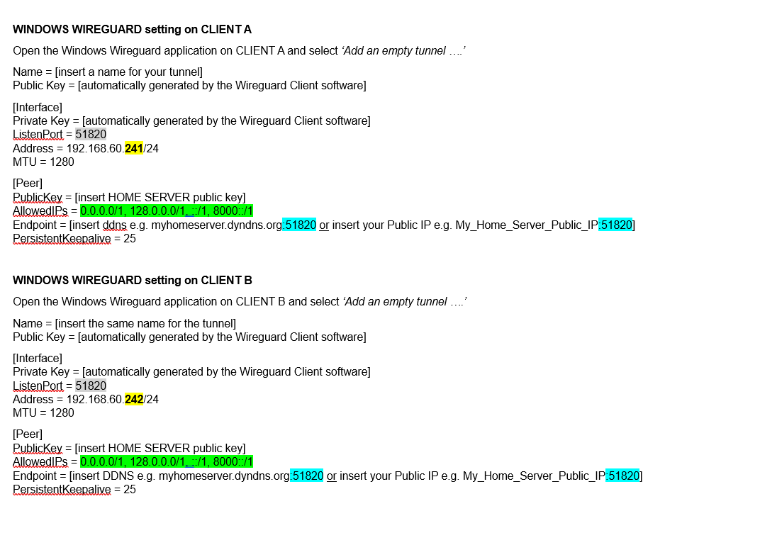

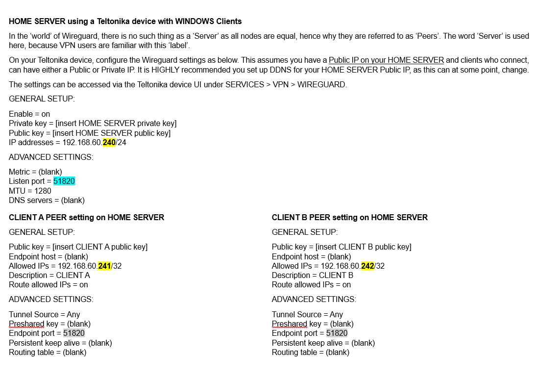

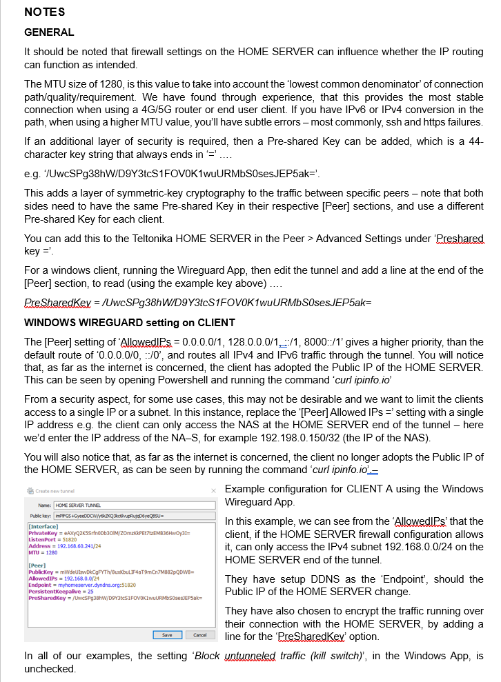

You will need a Public IP that is presented to at least one of your devices … is this the case?
If only one device has a public IP, then the other device has to initiate the WireGuard connection. If both devices have a Public IP, then it doesn’t matter who initiates the connection.
So assuming you’re fixed up with a Public IP on one of you’re devices, then see the following example …

As Mike mentioned, when configuring WireGuard, please ensure that at least one of your devices has a public IP address. For detailed setup instructions, please refer to our WireGuard configuration example on our wiki: https://wiki.teltonika-networks.com/view/WireGuard_Configuration_Example
