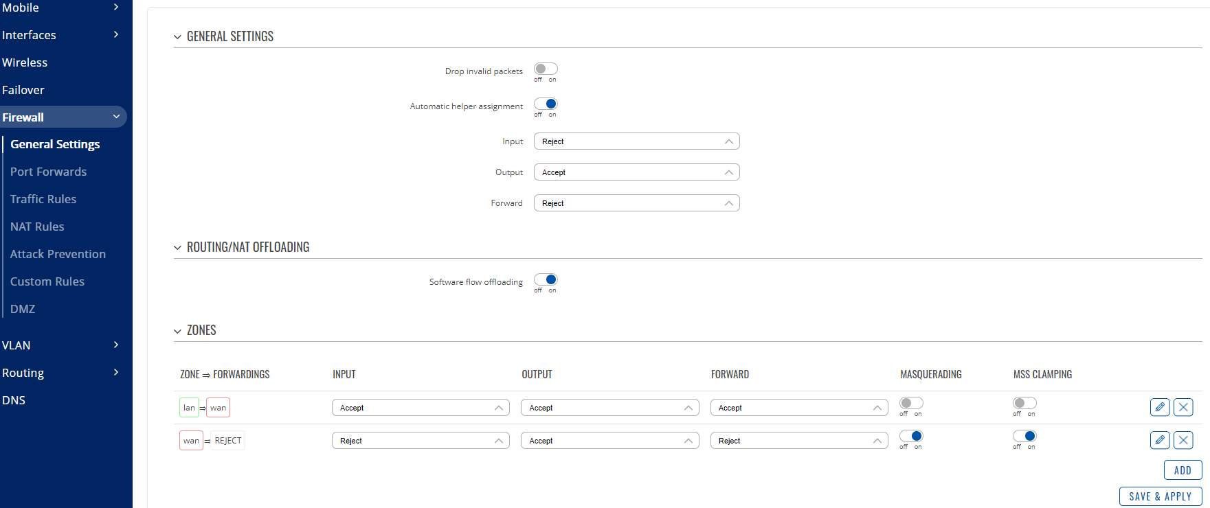

The port forwarding rule seems correct. Is mobile SIM your only WAN source?
Does the end device accept connections from other networks?
You can try enabling masquerading on LAN => WAN zone. This way, the traffic will appear as if it is coming from the router itself. Might help if the end device does not know where to route the packets or if it discards packets from other networks.

Cool . masquerading on LAN => WAN zone worked I can access my router.

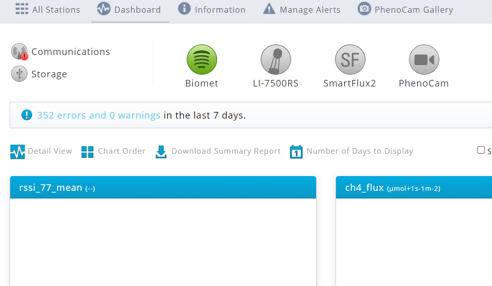

However, inside interface software we want to send our measurements data collected by the instruments to server. With previous router it worked fine. Serves has URL.
Our instruments company has webpage, where our instruments data are sent and we can see data that is updating every 5 minutes.
Somehow, this server cant get our data.

Since masquerading helped, but the end device (instruments) from LAN cannot reach the server on the internet to which it needs to send data, I would assume that the issue is with a default gateway on the end device (instruments). Please, check internet (TCP/IP) seetings on the device and make sure it has a default gateway set to the LAN IP address of RUT200 (RUT200 LAN IP address is in Network → Interfaces → LAN).
Let me know how it goes.
You were correct. Gateway address in both devices differed a bit. End octet was .31 instead of .1 as it was router LAN IP address.
