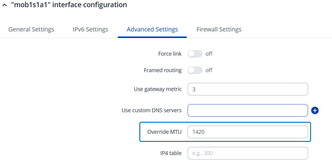

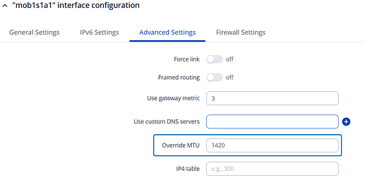

You can find the MTU setting (for the mobile WAN interface) under:
Network → WAN → mob1s1a1 → Edit Advanced Settings tab:
Set the MTU value (e.g., try 1420) and save the setting. Then accordingly test the internet connection through the VPN on your laptop and let us know how it goes.
