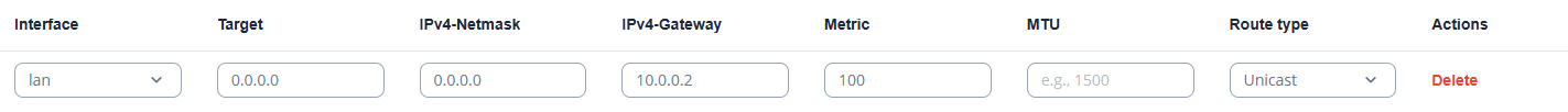

If that option is not available and you connect the RUT200 to a LAN port on the Fritzbox, both devices should be on the same subnet. In this case, you could assign a static IP address to the RUT200 and then add a default route on the Fritzbox so that traffic exits through the RUT200. Make sure to set the metric of this route lower than the main WAN route.
The route on the Fritzbox should look similar to the one shown in the screenshot, with the gateway set to the RUT200 LAN IP.
Please let me know if this helps.
