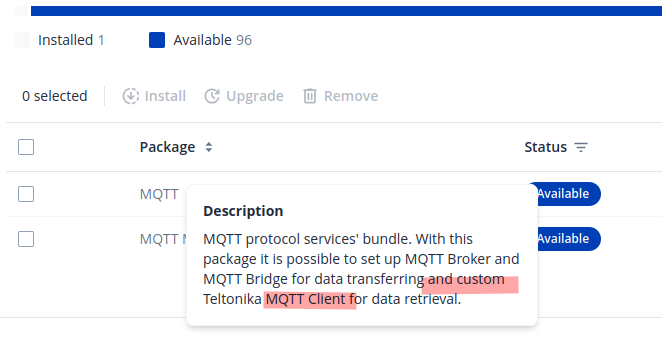

Thanks for the info. Before I try that, do you have an opinion on this?
If I hover over the MQTT package, I see this. Do you know if that is referinhg to mosquitto_pub & mosquitto_sub?
Regards, M
