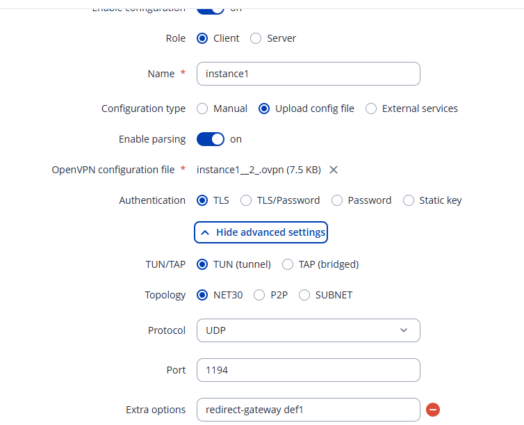

I manually created an initial OpenVPN client configuration which works fine.
As I wanted to redirect all traffic through the OpenVPN tun interface and avoid routing LAN traffic through WAN and Wifi client interface, I exported the manual configuration to a .ovpn file and editet it by appending the following line:
redirect-gateway def1
at the end of the parameter list just before the certificates section (see .zip content).
I disabled the intial OpenVPN configuration and created a new one by uploading the edited .ovpn file. When enabling the new configuration the log contained the following error:

I wasn’t able to reproduce the missing linefeed issue on a RUT142 running the same firmware. It’s possible that the text editor you’re using to open the file is altering the formatting. Could you try exporting the file and uploading it again without opening it first to see if the issue still occurs?
Thanks for the hint regarding redirect-gateway, seems to work fine and does what it should.
