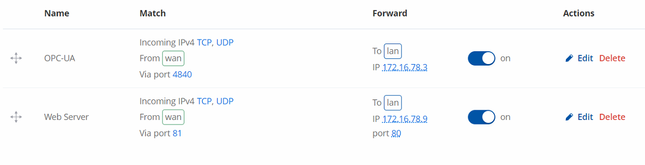

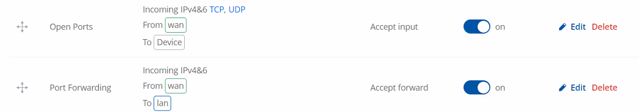

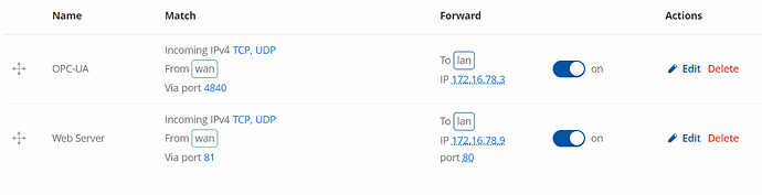

I have set up the port forwarding entries and tried various versions of traffic rules, at the moment I have them set to allow all incoming & forwarding TCP traffic and the port forward still doesn’t work. I have (Temporarily) enabled the web UI from the WAN port and it is accessible on the WAN port - the computer is connected directly so its not a routing issue or other networking hardware interfering.

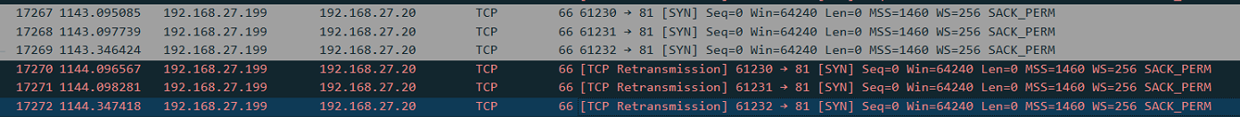

Wireshark from the WAN port shows the packets being sent then no reply, just retries from my computer.

172.16.78.199 requests connection to 172.16.78.20 on port 4840
Router forwards packets on to Server, without changing the source IP, server receives
172.16.78.199 requests connection to 192.168.27.3 on port 4840

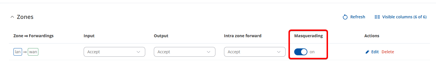

To fix this you need to enable Masquerading for the LAN->WAN Zone.

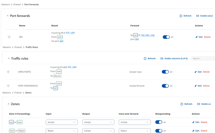

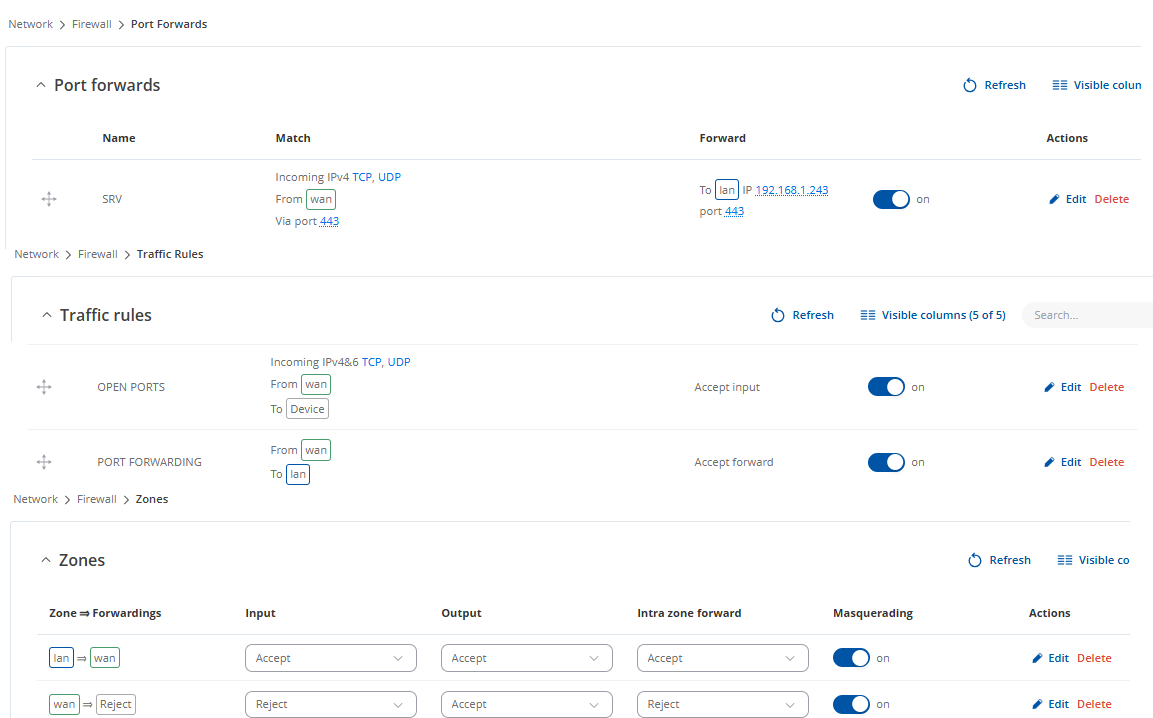

I set according to the directions from you and unfortunately during verification port 443 closed all the time.
I don’t even try it anymore to set only one specific IP address to access from one WAN address…
Can you give me some advice? RUT200 WAN SIM Card with fixed IP
I didn’t require the traffic rules in the end for my setup. I was just trying everything to start with, the port forwarding should be enough on their own. Try deleting them and see if that makes a difference.

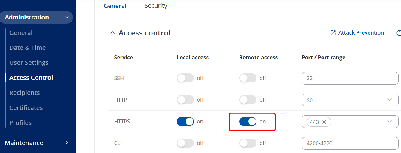

Have you tried turning on the web UI for external access and making sure you can access the router directly on https://externalIP - Don’t leave this on long term its not secure.
If you can’t access this then you have a larger issue than the port forwarding.

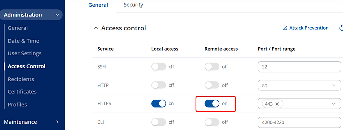

It could also be an issue with port 443 - depending on your settings it could be conflicting with the web interface for the router. You could try using port 444 (external) → Internal server port 443, then try accessing it on https://externalIP:444 and see if that helps?
