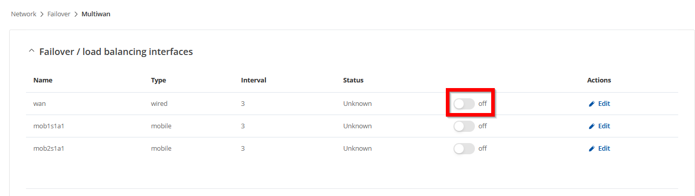

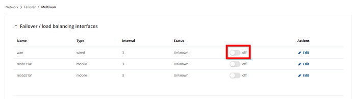

Thanks - can you confirm how to disable that WAN interface.
To turn off WAN Failover, follow these steps: Go to Network → Failover → Multiwan and then disable WAN interface Failover.
Marijus
I’ve reviewed both troubleshooting files and noticed that at your home location, you’re using 2 SIM cards. It appears that they are frequently disconnecting from one and reconnecting to another.
In other distant areas, it seems you only have one card, with no backup available as at home. That’s why experience disconnections. At the home location, you had another SIM to fallback, and in the other location, you didn’t.
Next time, I suggest turning off all failover options and testing devices with a single card at both locations with both cards respectively. I highly likely that at least one of the cards has bad coverage at a remote destination.
