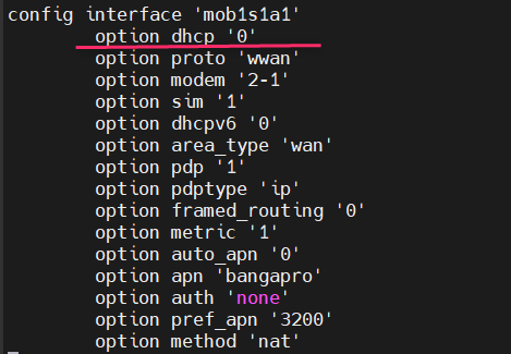

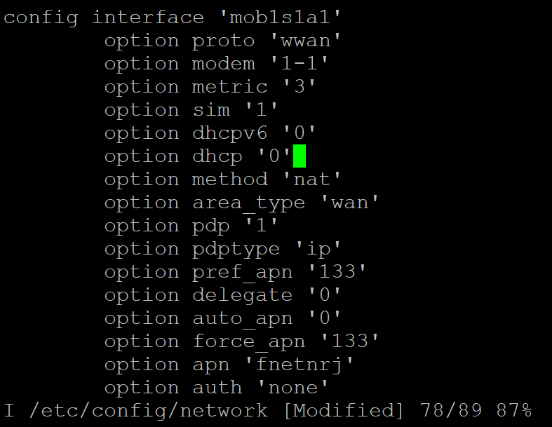

Could you try (if not yet) adding the following option to the mob1s1a1 interface in /etc/config/network to disable DHCP and use a static IP configuration?
  1. Run the following command to edit the network configuration file:
vi /etc/config/network
  1. Press “i” to enter edit mode.
  2. Add the following line under the mob1s1a1 interface section:
option dhcp '0'
  1. Press Esc, then type :wq and hit Enter to save and exit.
After making this change, restart the router and check if it improves the stability of the mobile connection.
If the issue still persists, please let me know so we can reach out to you privately and troubleshoot it further.
I have been add the parameter in the config file, now I’ll wait to see if the connection can stay more than 01h56m !
