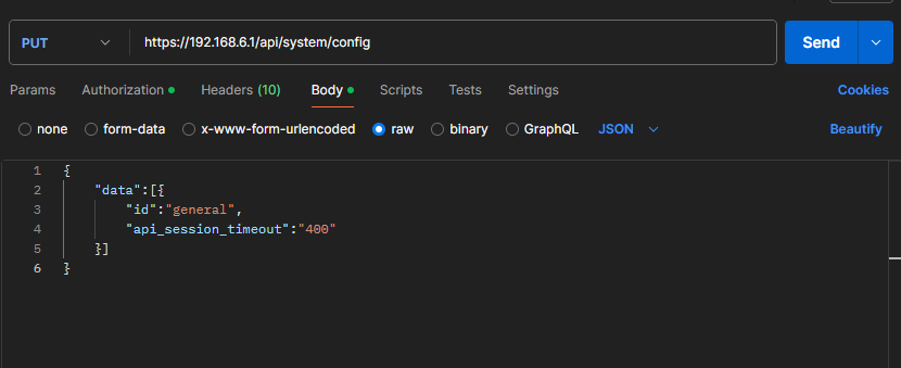

You should first log in and obtain a token. After that, create a new request that looks like this:
In the request body, you can specify your desired session timeout duration (in my example, it’s set to 400).
Make sure to select Bearer Token under Authorization and paste the token you received after logging in.
Additionally, you can extend the session time by following the steps outlined here: API access token - #3 by Martynas.
