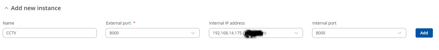

To achieve this, simply login to your router via WebUI and navigate to Network ->Firewall->Port Forwards enter the preferred name, and add new internal/external ports that are used on your CCTV camera for Web Interface. By default Web Interface uses 80, I suggest you change it to for example 8000 in your CCTV camera settings. Use the same ports for your router. If your camera is connected directly to your router, you should be able to see it in the Internal IP address section. When filled up, click Add → Save & apply.
If everything is done correctly, you should be able to reach your CCTV camera using your Public IP and port number, for example, 84.15..:8000.
