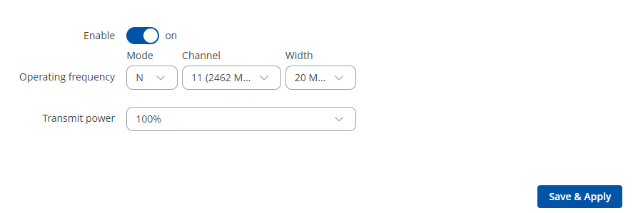

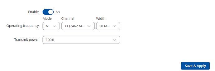

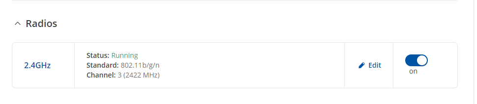

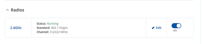

hi,
I have tried given commands through CLI but nothing changed, till channel 3 is selected…
I have uplode 2 images for your reference…
Thank you for the update. Could you please confirm if you have performed a hard reboot of the device (by unplugging the power cable and plugging it back in)? Additionally, could you let us know which country is selected in the Network → Wireless → Radio global settings?

Nothing Changed…all applied as per your advise…
Could you please confirm whether your device does not have a Wireless WAN (WWAN) connection set as the primary internet source? In other words, is your device not connected to another access point (AP) as a client?
If that’s not the case, please complete the form I’ve sent you. Use 11738 as the ticket ID when filling it out. Once submitted, we’ll contact you privately to continue investigating the issue further.
My problem has been solved. My AP was connected to another AP and worked as Client.
After set to single AP, I can change my Channel No.
