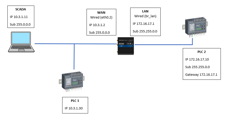

Apologies for the delay. Could you please confirm whether the initially described setup was achieved or if the issue still persists?
Also, I’d like to clarify this part of your description:
You mentioned “PC has the IP 10.3.1.11 and I want to send a ping to 10.3.1.10 and that the PLC at 172.16.17.10 receives it.”
Could you confirm whether you intend to:
Redirect traffic from 10.3.1.11 through 10.3.1.10 to 172.16.17.10,
or
Simply reach 172.16.17.10 from 10.3.1.11 via 1-to-1 NAT on the RUT200?
This part is a bit unclear, so it would be helpful if you could clarify it.

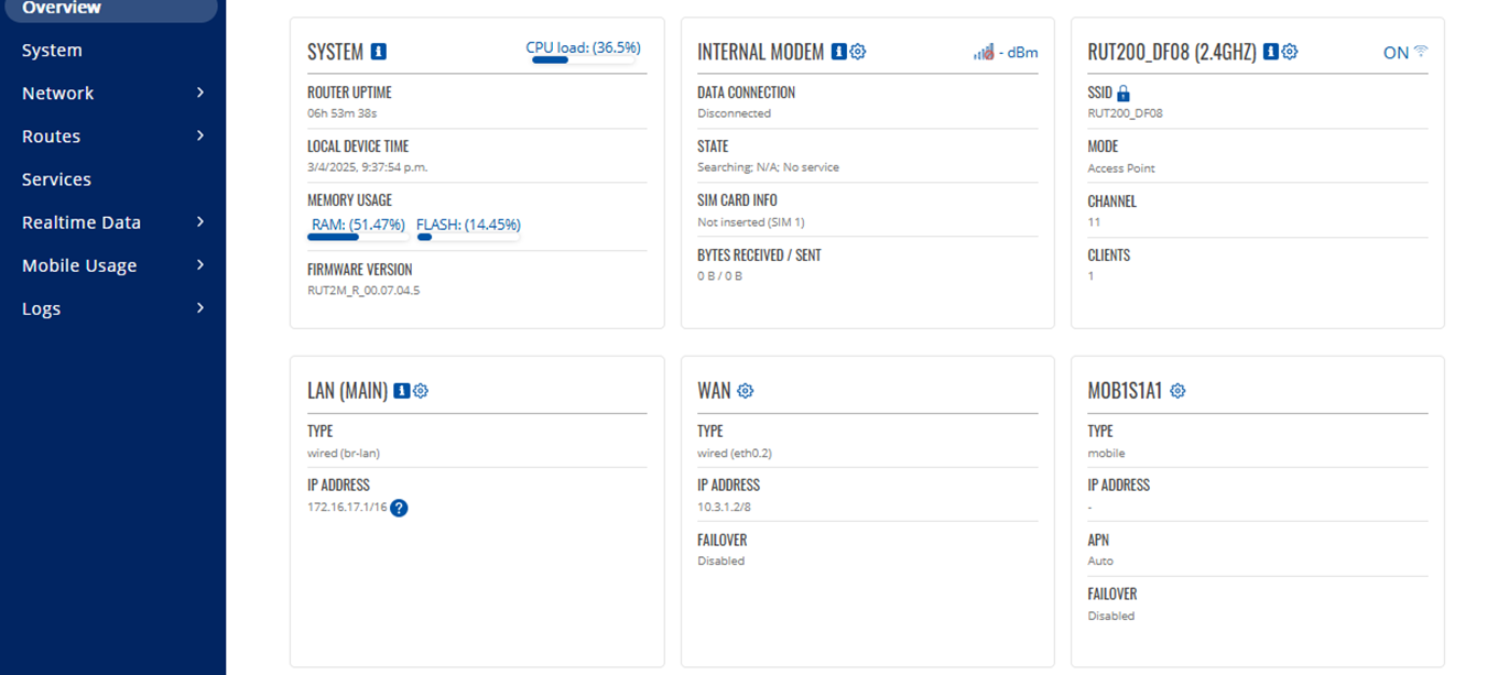

Your current iptables NAT rules look fine at first glance. Could you also check the following:
Is masquerading enabled on the LAN zone in Network → Firewall → Zones settings?
Which firmware version is your RUT200 currently running? Please ensure you’re on version 7.13.4 or a later release for optimal functionality.
