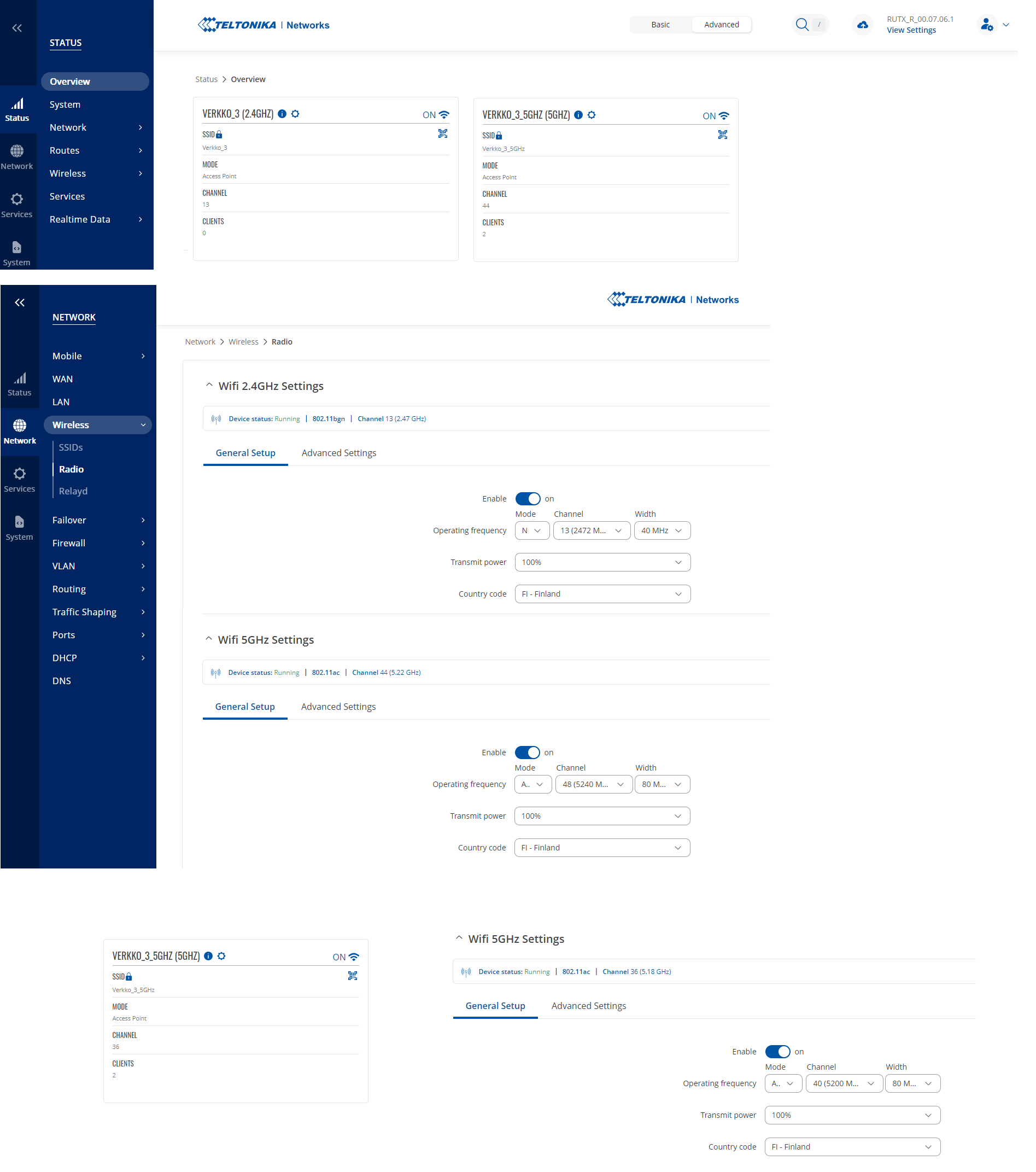

I have the stock 2.4 and 5 GHz WiFi networks running.
And in both I have enabled these settings that I found in another post here

I have been trying to use the Events Log to determine where the issue is. I mean is the issue the WiFi disconnecting or the actual mobile network connection.
/system/maintenance/eventlog/network
/system/maintenance/eventlog/connections

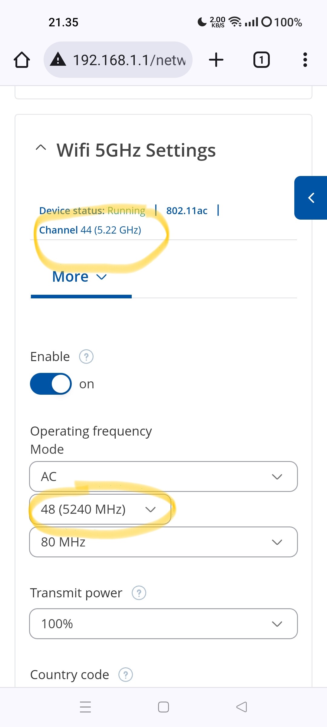

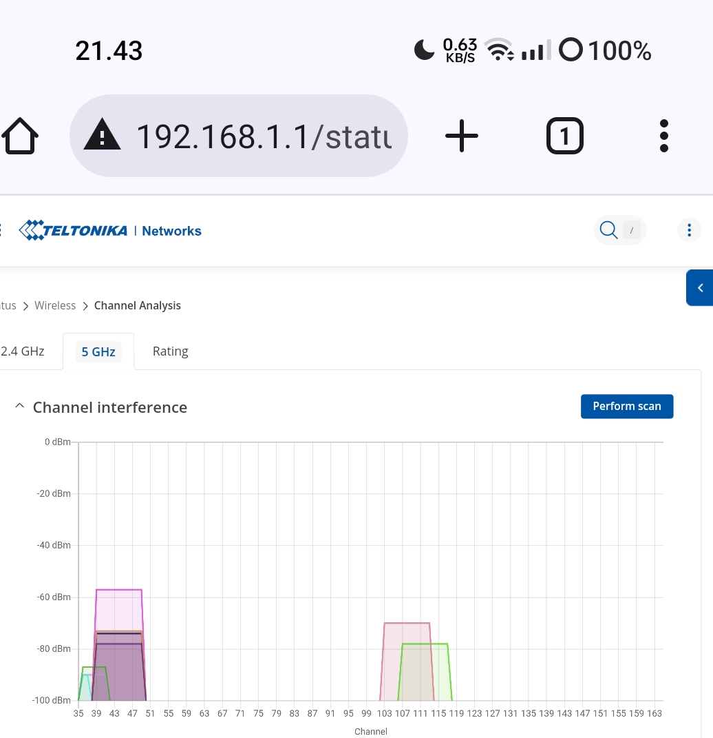

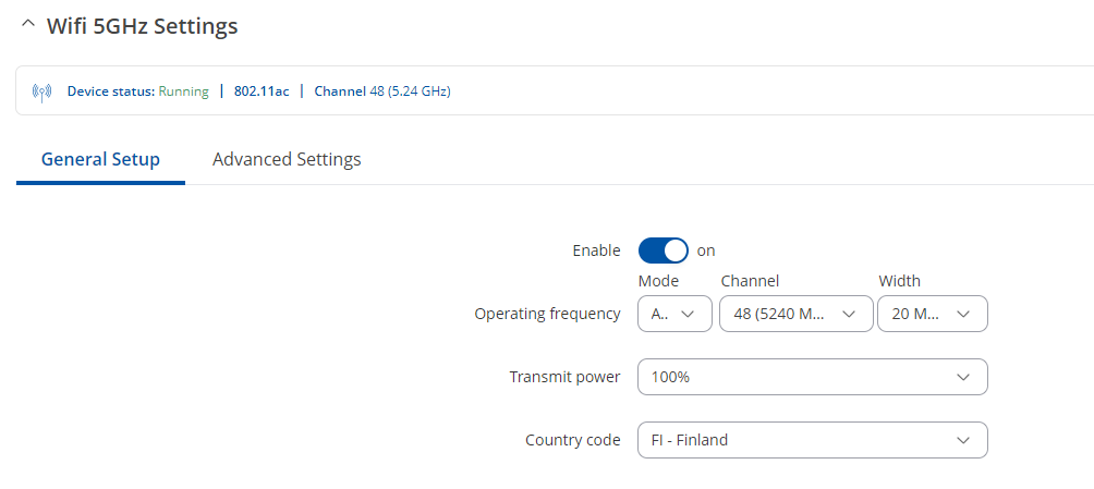

I checked used WiFI channels using the router and swtiched to channels not being used and that seemed to improve things for the rest of the day yesterday. Although I noticed now when checking that although I selected 5GHz band 48 or more, that the channel isn’t being used, the device appeared to be offering channel 44 anyway or have I misunderstood something?

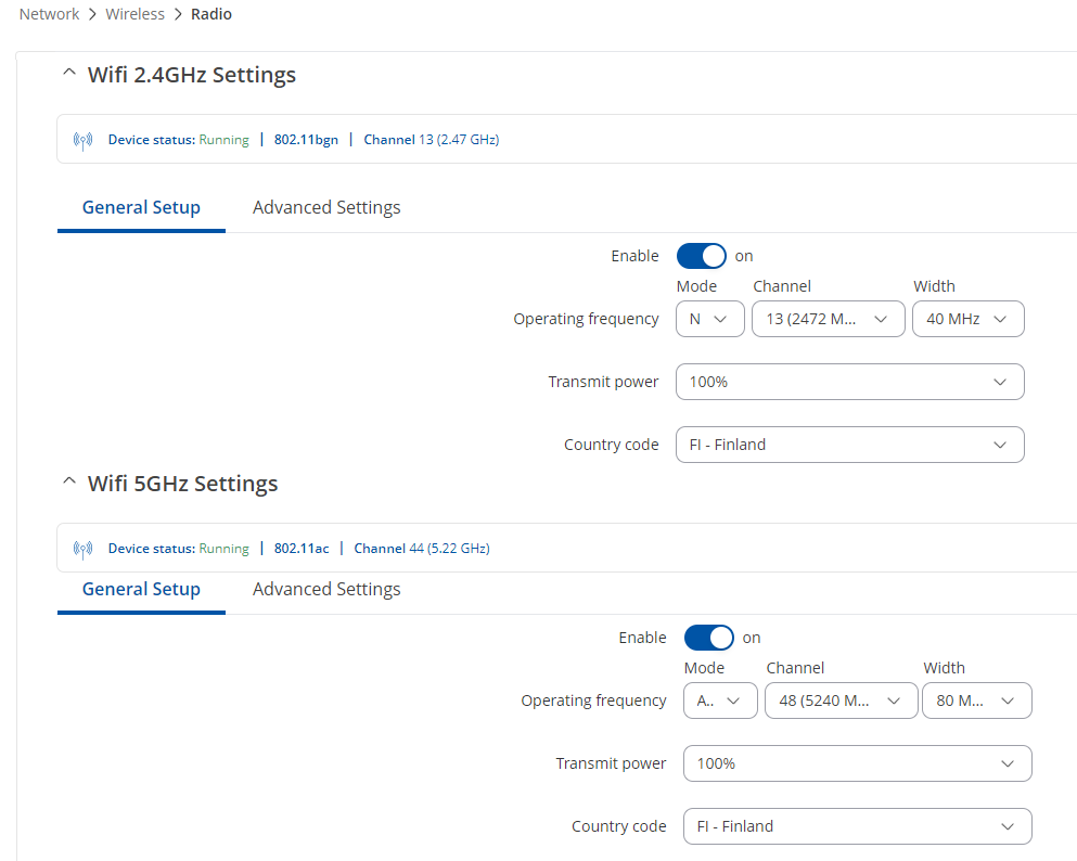

I have not been using 5GHz DFS channels. I only recently tried to use different channels, like 48. The router seems to be serving 44 though (a widely used band in my location). If I select a band that is not in use as reported by the WiFi scanner function, is the device supposed to serve only that band?
The router is supposed to serve only the selected band. To ensure this, you can manually restart the WiFi service after making the selection. Execute the following line in the router’s command line interface (CLI):
/etc/init.d/network restart
Marijus
Thanks for the tip. I ran that command, 48 serves 44 and 40 serves 36, or so it seems so I must be doing something wrong?

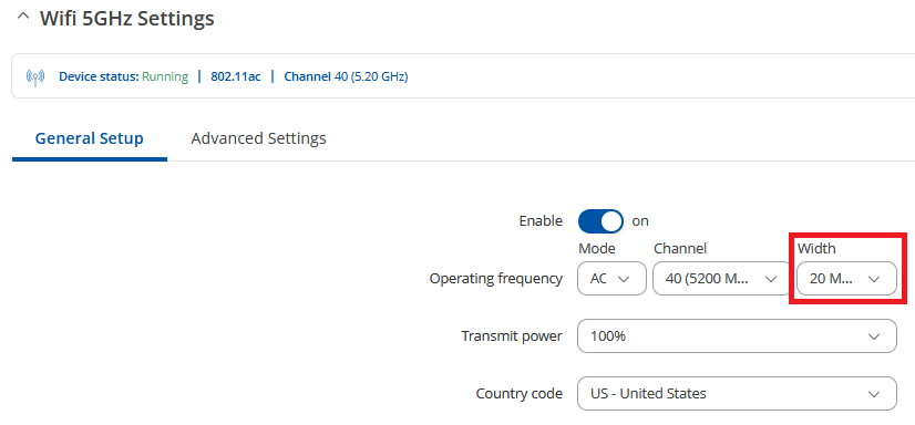

Have you considered switching to a 20MHz operating frequency instead of 80MHz? Using a higher frequency width can lead to issues like channel jumping, reduced signal penetration and range, susceptibility to interference, and compatibility problems.
Switching to 20MHz should resolve the channel jumping problem.
Marijus
Yes that sorted it, thank you @Marijus :wink:

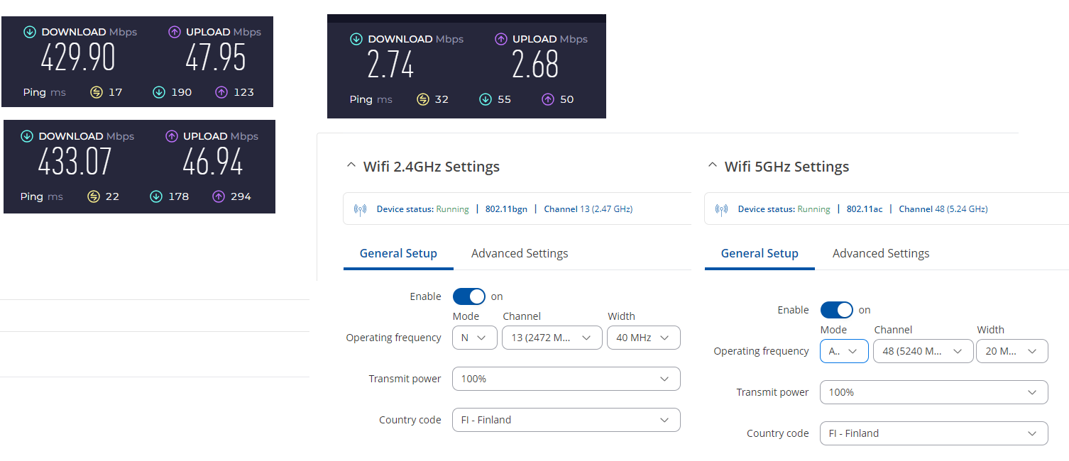

I booted up the router this morning, I did not change any settings yesterday and today the WiFi speed on both SSIDs will not go > 3 mbps. I tried recreating the SSIDs and radio settings to see if that would help but it did not. I have no idea what is going on with this one. LAN speed on the left, WiFi 2.4/5GHz on the right.
[EDIT] I factory reset the RUTX50 which resolved the WiFi issue.
