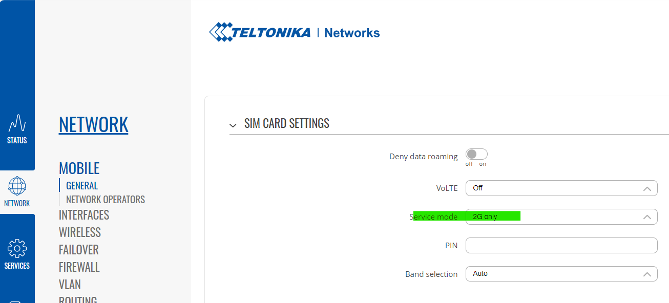

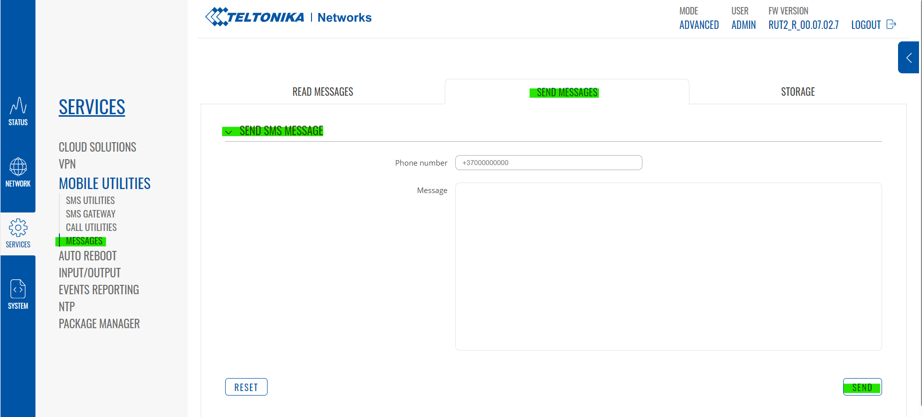

I have purchased RTU240. Now I am testing SMS function.

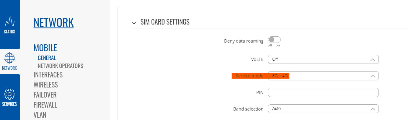

When I set the SIM setting as 2G, I can send the SMS message. But when I changed the SIM setting to 3G or 4G, I can not send the SMS message.
Is this function limitted by product features or I need to do more configuration on the device?

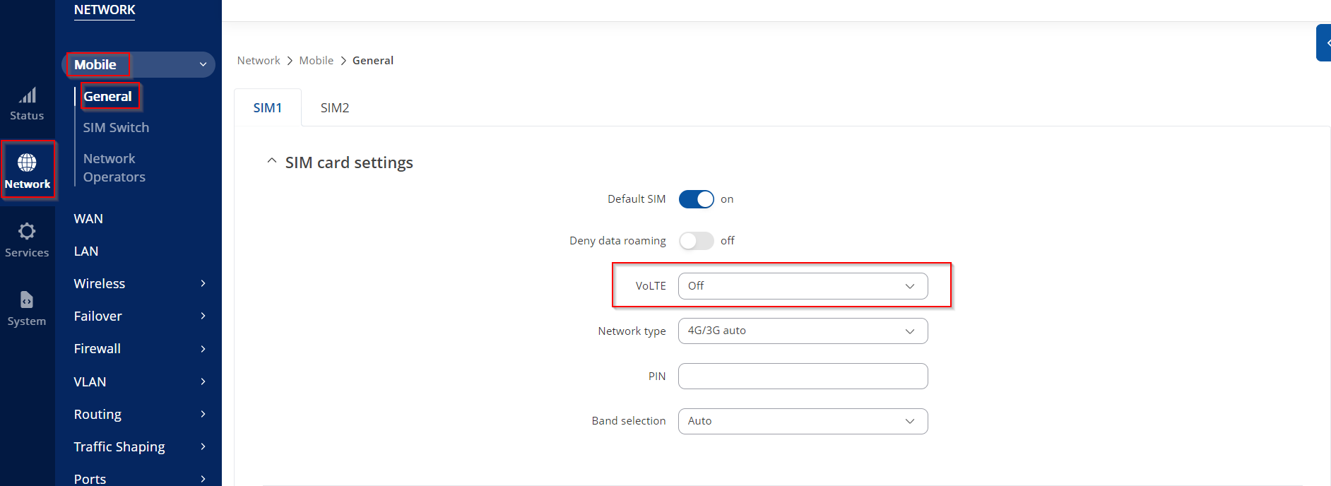

Kindly try disabling VoLTE
To disable VoLTE by navigating to Network → Mobile → General settings;

I’ve tried this way but device still can not send the message with 3G or 4G network.
Please show me if there are any other settings I should try.

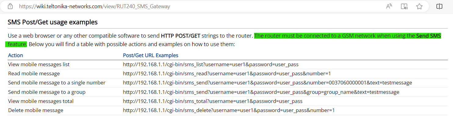

I read on device manual. About SMS sending function, it works only on GSM (2G) only.
Does it mean that the device can not send SMS on band 3G or 4G?

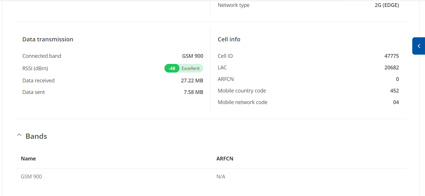

I’ve tried to set mobile network as 2G, the band is GSM (device can send SMS)
And when I set mobile network is 4G, the band is LTE B3 (device can not send SMS)

I’ve conducted a test on my end, and I can receive SMS messages.
Could you try putting the SIM card into your phone and checking if it sends an SMS message?
What APN is used when the SIM card is inserted into your phone?
