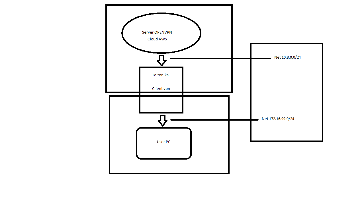

I have a problem when routing a VPN server with a teltonika, I have the VPN server with a vm, it has a public IP and the IP that generates the VPN which is 10.8.0.0/24 and its other networks, now I generated the .ovpn file and uploaded it to the teltonika which has communication with the server, but the problem I have is that from the server it can only see the vpn interface but not the other teltonika interfaces such as the lan, How could I route the VPN interface and the LAN from the teltonika, the VPN has the network 10.8.0.2/24 and the LAN 172.16.99.1/24

I have already seen the configuration, but in my house the VPN server is in an AWS cloud, with the network 10.8.0.0/24, but when trying to reach the interface 172.16.99.0/24 they cannot be seen, from the cloud You cannot see the LAN interface but from the teltonika you can see the cloud interfaces, most likely it is a lack of some routing on the teltonika equipment.
The equipment I am using is a RUT240
By default, this setting is not enabled. To make it reachable, you can follow this quick tutorial: Tutorial Link
