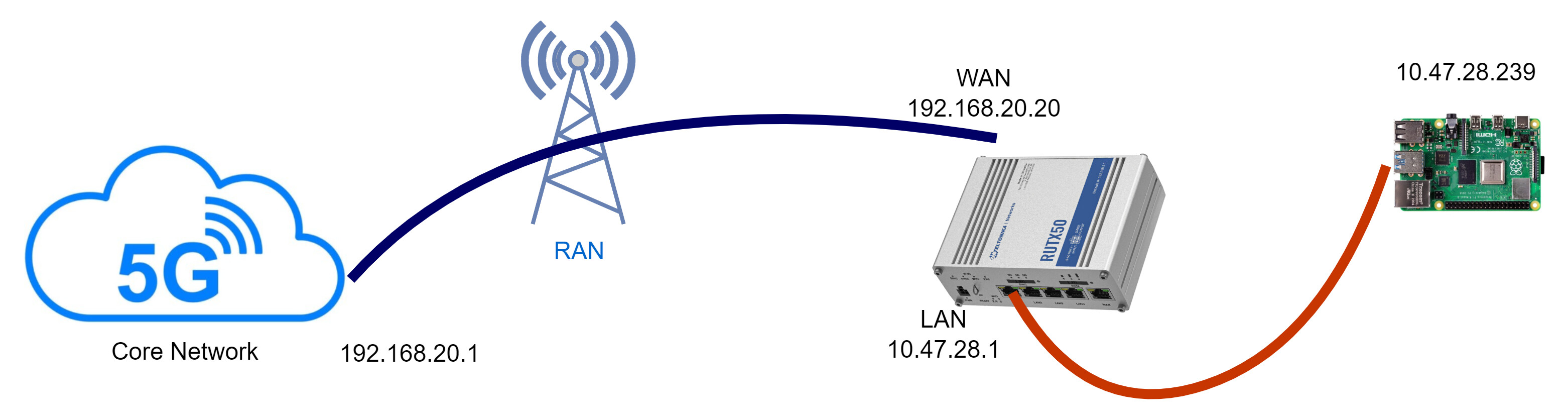

Hi athurr,
do I understand correctly that 10.47.25.1 is the WAN side, and
the LAN side is 10.47.28.0/24 with 10.47.28.239 being the RasPi?
(if not post send a drawing!)

I made a mistake,
The WAN address (mob1s1a1) is 192.168.20.20
The LAN address of the modem is 10.47.28.1/24
The LAN address of the raspi is 10.47.28.239
I can ping, tcpping, udp traceroute 10.47.28.239 from core network (192.168.20.1), but I can’t curl or ssh 10.47.28.239. However, if I port forward ports 80 or 22, I can curl 192.168.20.20 or ssh 192.168.20.20 and I’ll go straight to the raspi. But I do not want that and need direct routing because in the end, there will be multiple devices behind the RUTX50 and I need to reach those directly.
Here’s a diagram :
I need pure direct routing, no NAT, no masquerade, no DNAT or SNAT or whatever NAT, just routing, to work.
At the moment, icmp, tcpping and udp traceroute works, but no curl or ssh from 192.168.20.1.
