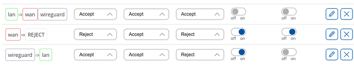

One question from me, and I realise we may well have been fiddling with this in code and that you probably see it in the routes/logs, but is this the way we want the firewall or do we want to let the wg interface send to wan?:

In the firewall page, set Wireguard=>lan to Accept/Accept/Accept.
