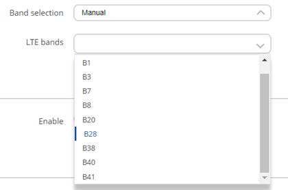

    I was also checking if I can force specific band in the router UI:
    I noticed that I can do so in the RUT955T03XXX and I’m confused why
The RUT955TXXXXXX module should not have support for B28. However, it is equipped with the Quectel EC25-EU, which can support this band. The device you have must have a custom product code with B28 unlocked, to know for sure I would need a full product code. There might be a naming issue causing confusion too.
