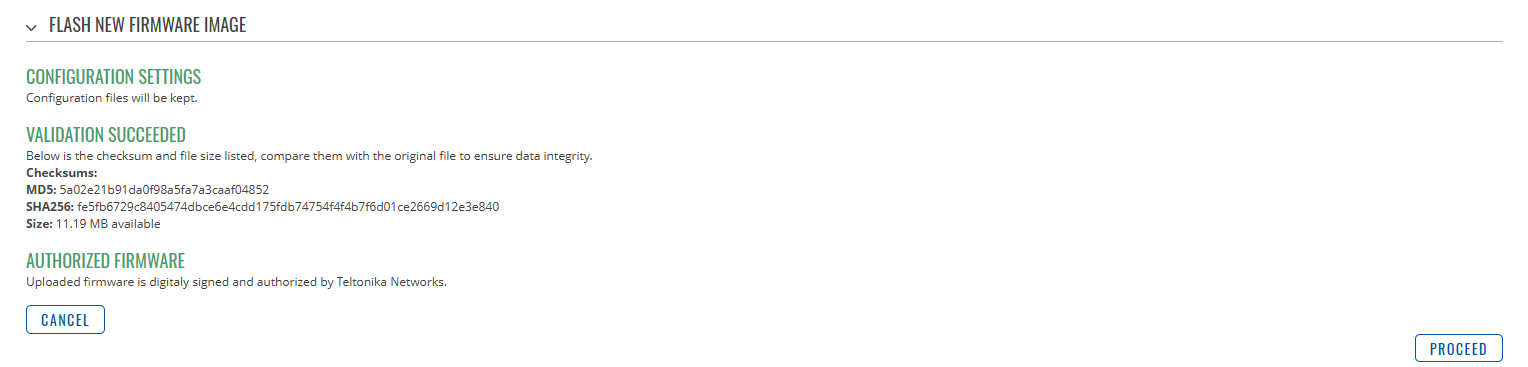

In a router 955 product code RUT955T03XXX the checksum doesn´t match with the one provided in:
RUT9 Firmware checksum list - Teltonika Networks Wiki
I have tried several firmware files from the page:
RUT955 Firmware Downloads - Teltonika Networks Wiki
and none of them matchs the checksum code provided in that webpage. Also, the router shows everything is ok with the uploaded file and allows the possibility to proceed with the updating.
This router had installed a rut9XX_R type firmware and was updated to an RUT9_R_00.07.00 previously.
The question is if may I proceed with the updating since the checksum does not match the one provided by teltonika in it´s webpage.
Thanks in advance.
